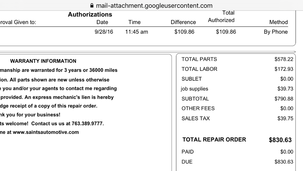

Hi guys. This is my 1st post. I wanted to share with you what my mechanic found.
1998 accord 4dr lx 4cyl
Needs a new distributor assembly.
He wants:
Distributor $578
Labor $173
Job supplies $40
Taxes $40
Approx. total $830!!!!!!
Now Im not a mechanic but that seems nuts. I took shop for 4 years back in HS. Ive done a few distributors and they were simple. Unplug, unbolt. re bolt and re plug. == good to go
And the distributors were nowhere near $578!!!!
What do you think? Should I have towed home and do it myself?

That price is likely for the OEM Honda distributor assembly. Did the mechanic say what was wrong with the distributor?
The Honda distributor is pretty simple. I've installed the distributor 180 off, so I just remove the distributor cap to see where the rotor is pointing and leave the wires on. The 98 distributor didn't have slotted holes and just bolts on, so you shouldn't have to worry about setting the base timing.

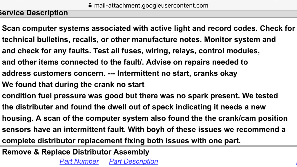

Old Sep 29, 2016 | 11:04 PM
Posts: 16,335
Deleted the first picture as it had your personal information on it.
I think the dwell test is due to the spark timing being off. The cam sensor is in the distributor, but the crank sensor is on the engine block. You may want to scan and get the actual codes to see what sensor/wiring is giving the error code.
You may want to remove the distributor cap and look for any obvious problems/damage on the wiring inside. Look for a red powder in there indicating a rusting bearing.
I don't see a ton of distributor issues on this site for the 98-00 accord like the early 90s accords, so you could save some money and get a junkyard part with confidence.

Ok, so you were/are having a no spark issue. According to them, the distributor housing is shot because the dwell is off. I thought that was controlled by the iginition control module (ICM), and or the CKP/TDC sensors (found behind the harmonic balancer). My only concern would be replacing the entire distributor, only to find it didn't fix the problem, because it needs the CKP/TDC sensors replaced instead/too.
Part of all this stems from my own "no start" issues. Although mine was fuel related, I still went thru the ignition system (among other things). I was looking at several things, and found replacing some items inside the distributor would be almost the same cost as a rebuilt unit from Rock Auto, so I bought one. Then I ended up replacing the CKP/TDC sensors because I was getting some funky readings that didn't match my 97 FSM book. Plus, with 234K on it, I could see that maybe it was worn some. But upon removing it, and testing it, it was fine. But with both parts replaced (maybe not with genuine Honda parts), I know I shouldn't have an issue on that part of the system for at least a year (it's warranty period). Plus, I still have my old parts that I can go thru.
Basically, I think I'd get it home, do a little online window shopping, and go from there. By the way, when was the last time the timing belts were changed?

The Toecutter: I also am concerned I have them replace it and still doesnt fix problem. Thats hy Im not comfortable having them replace it for $830 only to find another $500 that needs to be done. I'd rather replace myself for less then $100 and find more issues.
