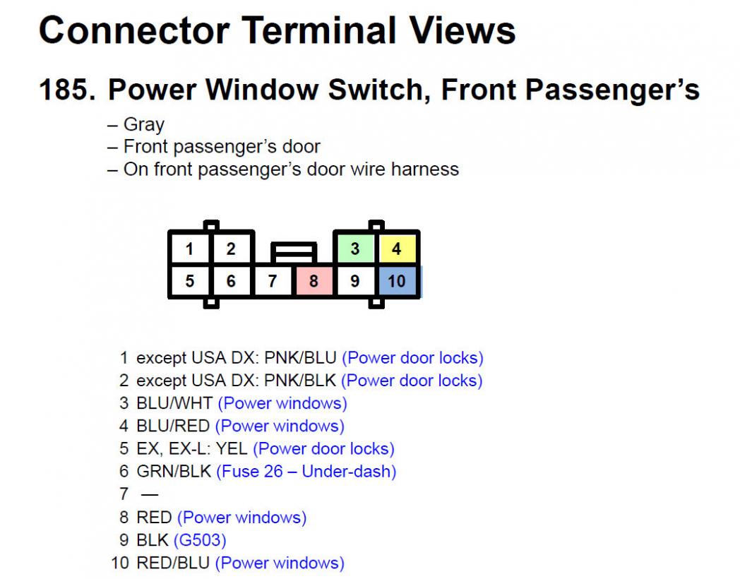

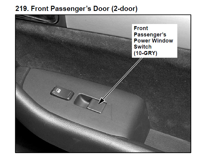

If you want to test without removing a door panel:
1. First check that under-dash Fuse No. 26 (20A) is not blown.
2. You can do the test in my post #3 of this other thread first (the link was included as part of this thread already). -- This is to check if it may be a problem with the driver's door multiplex control unit. If this unit is not working properly, you won't get a reading in the next test (step #3). https://www.hondaaccordforum.com/for...t-budge-59199/
3. Carefully pry up the passenger side power window switch trim panel. Unplug the gray 10P connector. Place voltmeter's terminal lead in the cavity terminal no. 3 (Blu/Wht wire) and cavity terminal no. 4 (Blu/Red wire). At the driver's door master window switch, try to operate the passenger side window. It should show voltage when trying to operate down or up. The power (+) and ground (-) through those wire are switched to operate the motor up/down. If there is voltage on the Blu/Wht wire and Blu/Red wire, it can be either a faulty passenger window switch, a faulty motor, or an open (break) in the wire to the motor.
4. Alternately, you can skip the steps above and proceed directly to test the motor from the gray 10P connector at the passenger side window switch. With the 10P connector unplugged from the switch, apply direct 12 votl battery power (+) and ground (-) to cavity terminal no. 8 (Red wire) and cavity terminal no. 10 (Red/Blu wire).
Power (+) to the Red/Blu wire and ground (-) to the Red wire should make the regulator go up; switching power and ground to the respective wires should make the regulator go down. Only do these briefly, so as not to burn out the motor if it is good.

Did some testing today. Fuse 26 seems to be ok. However I noticed it has power without a switch being activated. I thought I read somewhere that it only had power when the switch was activated??
I then used a test light to check for voltage at the passenger wire connector. Terminals 3 and 4 did show voltage when the drivers switch was activated. I noticed something strange when I did that test though. The voltage did not turn off right away after the switch was released, sometimes but not every time. It was only on the window up side. A couple of times it didn't turn off until I pushed the switch the opposite direction. Is that normal? My first thought was that is was for the auto up/down operation??
After that I did take the passenger door panel off and checked for voltage at the two wires going to the motor. Both wires had switched voltage. One with switch up and the other switch down. This was from both switches.
For the heck of it I then connected a 12v battery charger to the two wires. Not sure if that was the best power source but I thought the motor would try to do something if it was ok. In both the 2 amp and 10 amp charger settings the motor did not budge or make a sound. I tried reversing the polarity but had the same result.
I assume all this means that it is the motor? Is there anything else that I should still check before proceeding with a new motor/regulator install?
