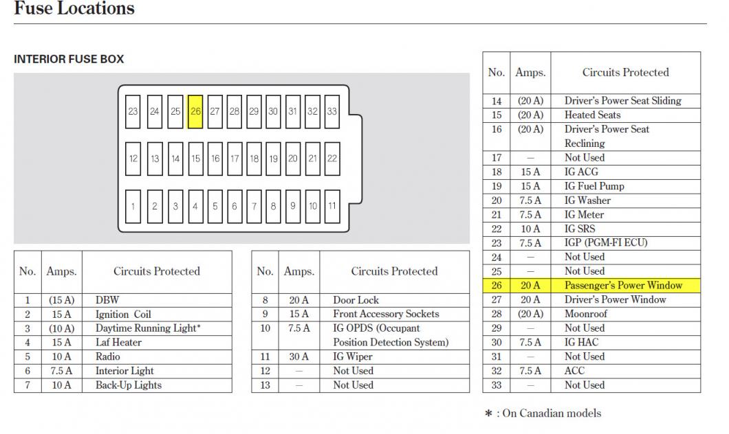

Old May 29, 2014 | 10:41 AM
Posts: 7,101
This is an image of the location of Fuse No. 26 (20A). If the fuse is blown, only replace with a 20A fuse, do not use a higher amperage fuse.
Attached Thumbnails 05 coupe, passenger window will not budge-interior-fuse-box.jpg

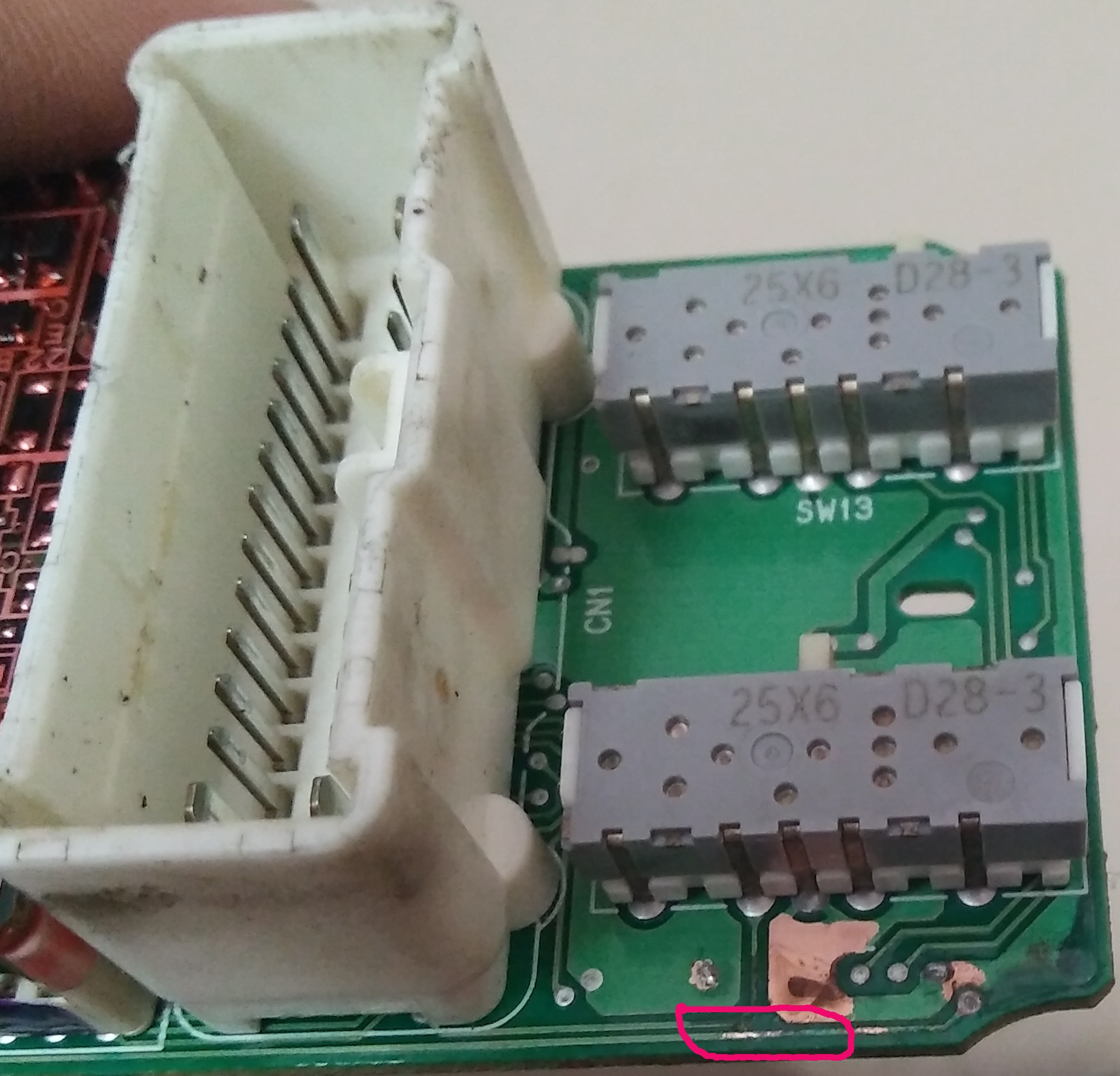

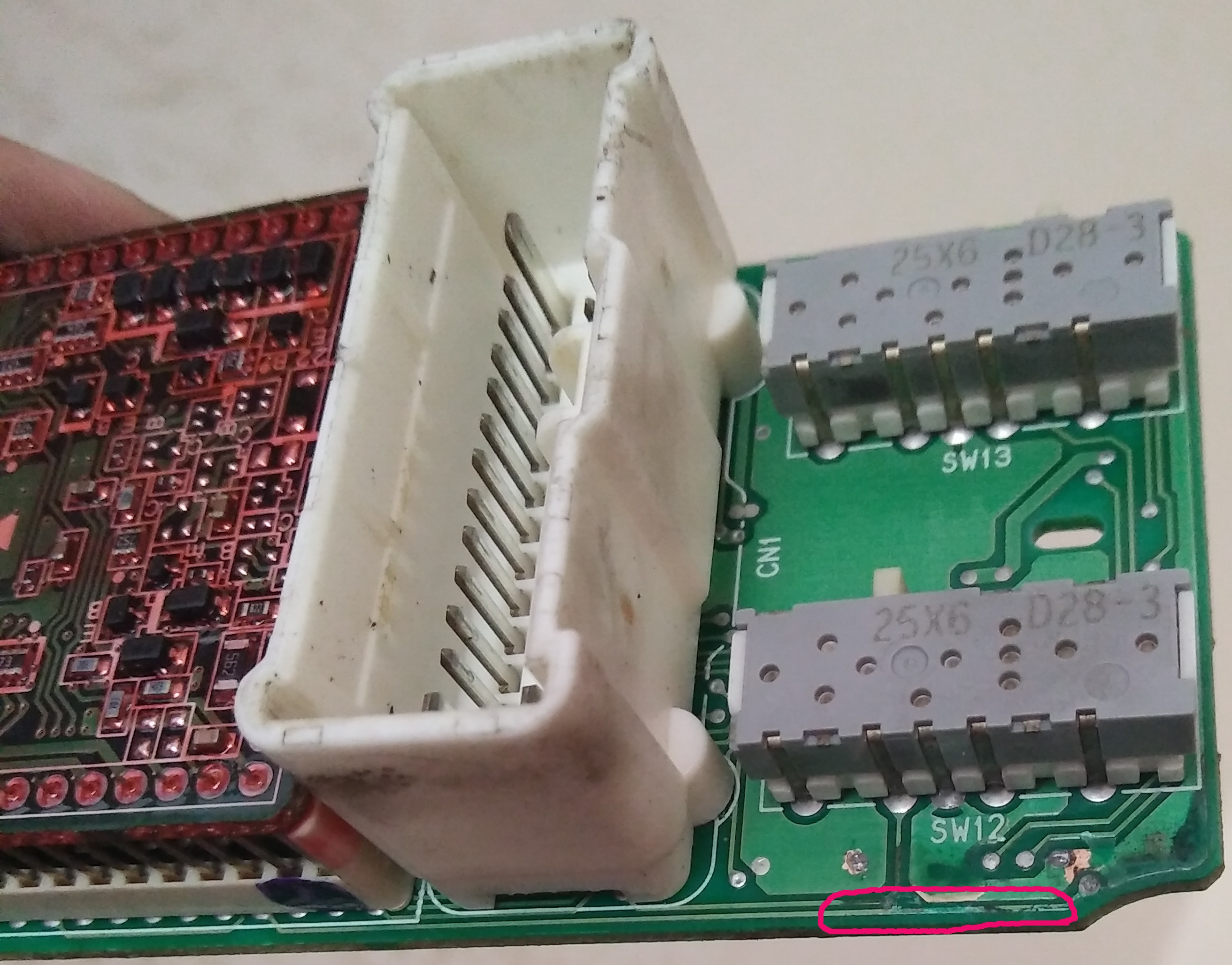

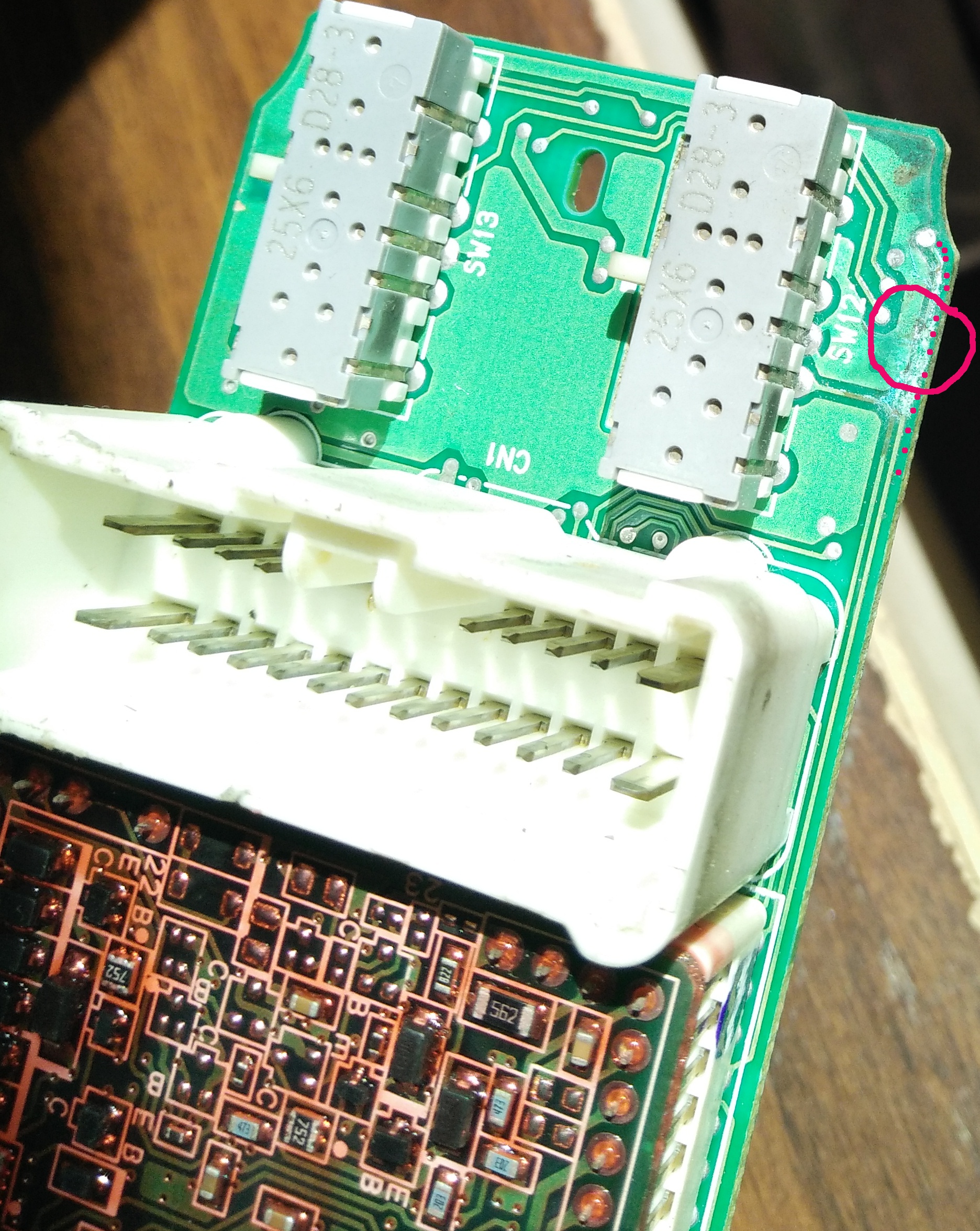

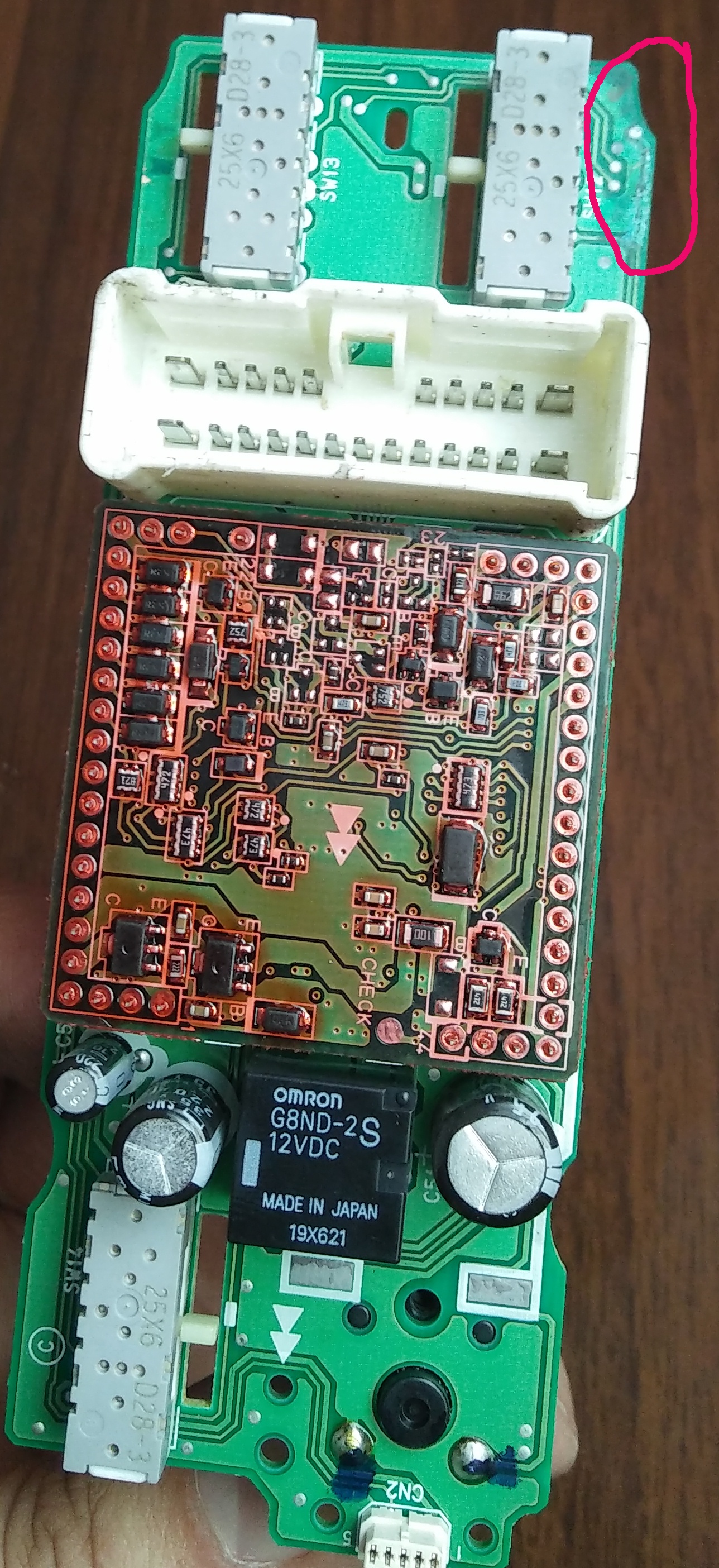

Talking Solution to 3 windows not going down
Hi all,
I have used the information in this thread to open the control unit for the windows ... I noticed one copper track failed the continuity test with corrosion sign (look at the images below). I soldered a jumper wire to correct that and it worked fine.
I have not done the test described above in this thread ... since the symptoms were exactly the same.
Hope this would help others.
Regards
A.C
