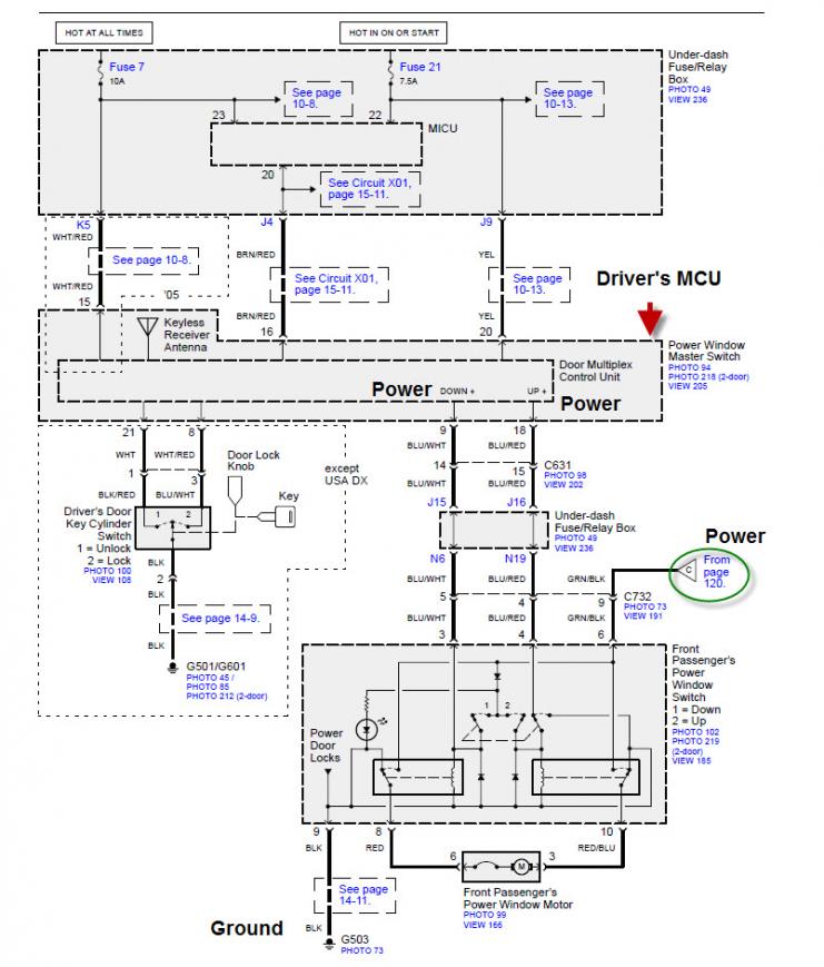

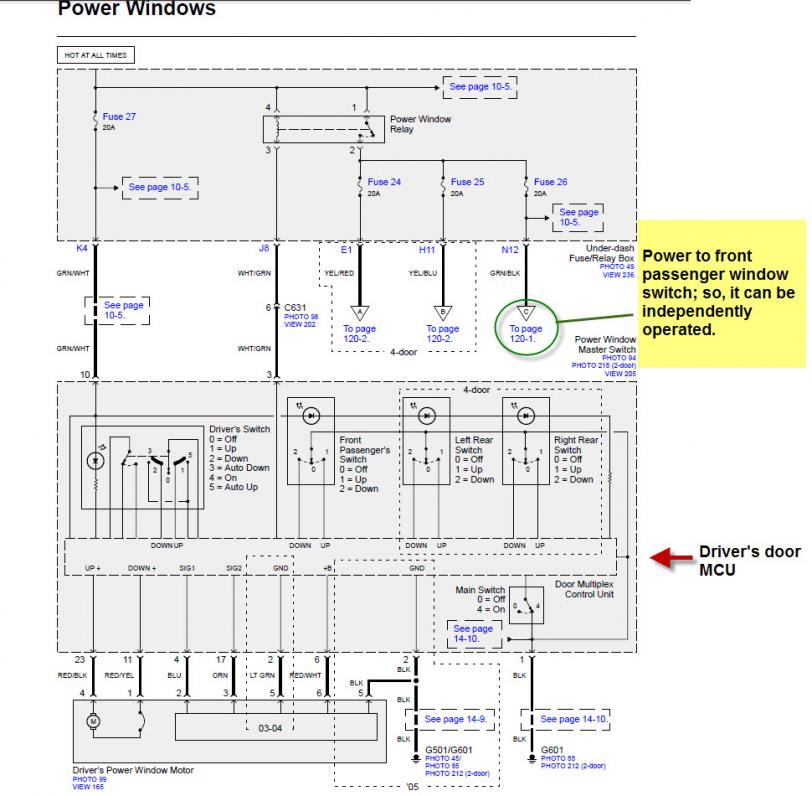

1. My best guess from what you described, is a faulty driver's door multiplex control unit (MCU). The door mcu is part of the driver's master window switch. The driver door mcu also controls the auto up/down function.
2. I've attached the circuit diagram for the power windows. In the diagram, you'll see that Fuse No. 26 separately provides power to the front passenger window switch so that it can be directly controlled by the front passenger; without going through the driver door mcu.
The driver's door master switch can also control the front passenger window through the passenger switch by separately supplying power. My guess is that when the driver door mcu is acting up, it may interfere with using the front passenger window switch.

It does seem like it's a control problem more than anything else at this point. What I wasn't sure about though was whether the passenger switch could cause the described symptoms by itself or not.
