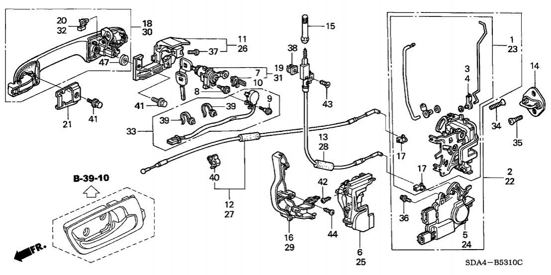

Still sounds like a linkage problem. I guess (not sure) that there's some kind of feedback where the system "knows" that the driver door has not unlocked. In hindsight I guess my suggestion didn't really prove anything different.
Hard to tell on the parts drawings, but it seems the electric actuator operates the lock through a different cable than the key cylinder. I'd remove the inner door panel and have a look around for disconnected cables.
