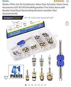

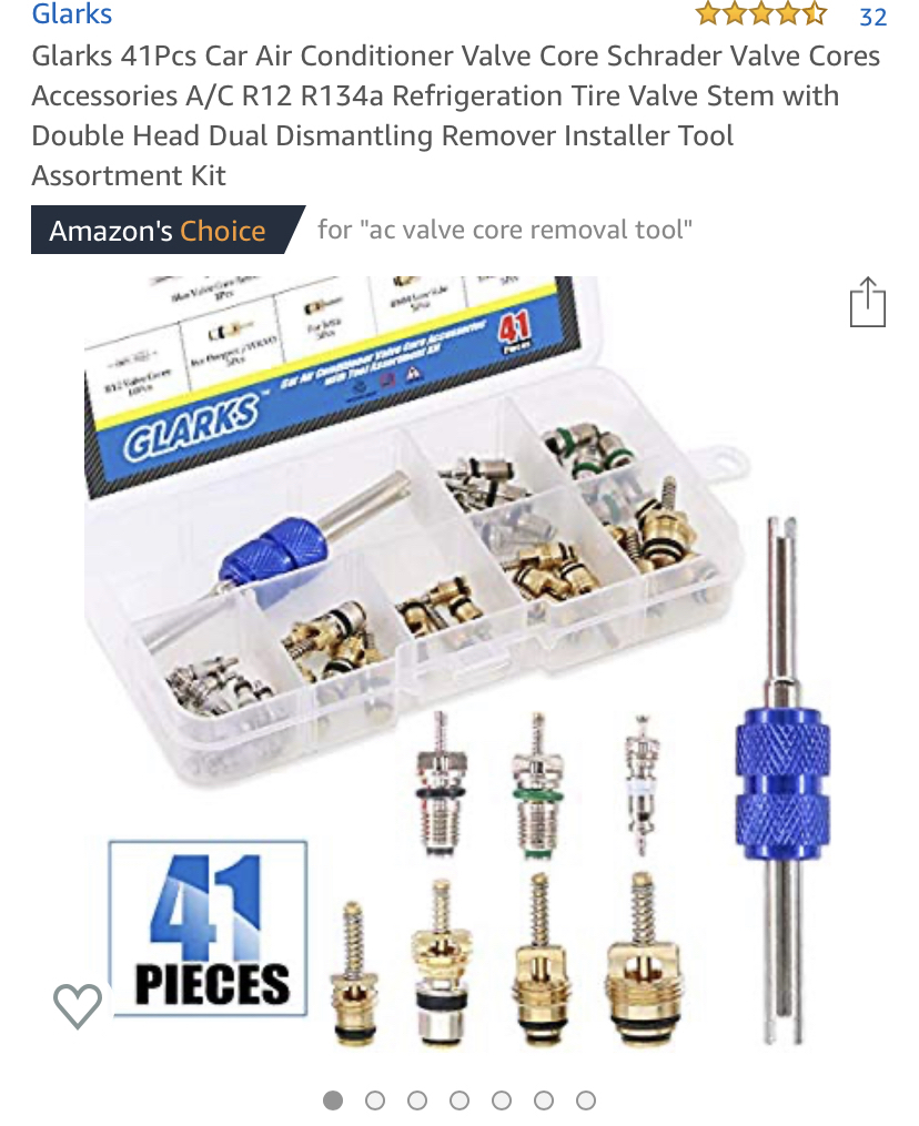

I'm assuming you are referring to high and low side cores? Also what tool do I need? Would you have a diagram of the complete list of parts?
Old Sep 30, 2019 | 04:14 PM
  #47
Seanjordan20's Avatar
Joined: Jun 2017
Posts: 1,225
I don't know about a list the 2 links is all you need to complete the job and the core valves attached.

Sorry my bad, somehow I thought the cores were some sort of rad in front of the fans. Long day. Anyhow I ordered all the stuff, went with rock auto as the compressor was new not a refurb. but ended up being about $100 more. Getting stuff to Canada is always tricky and if I ordered the two links you sent from ebay, it would be more things that could go wrong and shipping damaged or defective stuff back is astronomical. Rock auto returns and warranty are pretty good. I order a fair bit of stuff from them as it is less expensive than buying local even with the shipping. Would be nice to buy local but the prices have to be descent.
Cross your fingers that everything goes well. Not looking forward to getting at that compressor. I'm going to watch a few you tube videos first. I still have to figure how much oil and what to lube before installing. Sounds like I can mess things up with not enough or too much oil or Freon.
