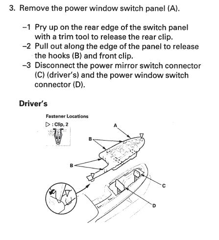

I don't see anything in the diagrams about by-passing the lock out.
Switch replacement is not that hard, I don't think the whole door panel comes off, just the switch.....do you have a two or four door?
Attached Thumbnails '06 Accord LE- Passenger Window Switch Failure-7th-gen-window-switch-4dr.jpg
