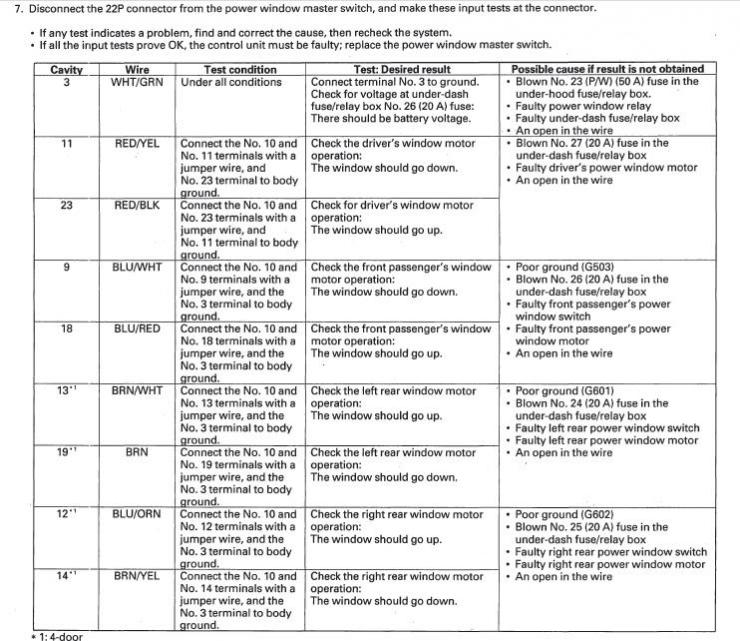

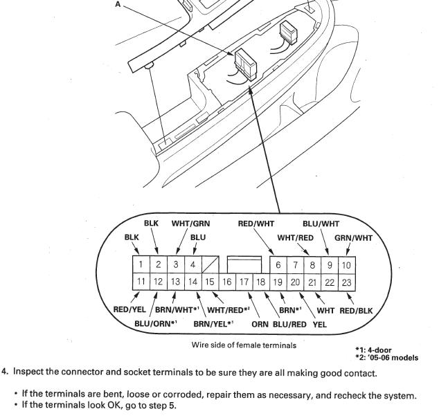

Any recent work done to the car?
Do you have a volt meter? If so you can test the inputs/outputs of the switch.
These two pic's are just part of the testing, all you need for this is something to "jump" the pins......two pieces of wire

Thanks for your response. I'm beginning to believe that the problem is in the window locking switch. When I hit each respective window switch for the 3 passenger windows, I hear a click in the window switch on each individual door which leads me to believe that I'm getting power from the master switch to each door switch. Can you tell me how to either repair or disconnect the window locking switch? Since I don't use the window locking switch anyway, I'd rather just disconnect it if that's the quickest fix. Thanks again for your advice. msartell
