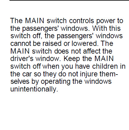

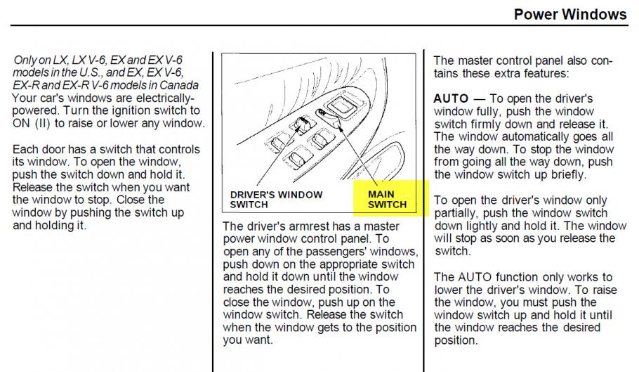

Make sure the main switch on the driver's side master switch was not inadvertently switched off. See attached pics.
Attached Thumbnails Passenger Power Window Suddenly Stopped Working-main-switch.jpg   Passenger Power Window Suddenly Stopped Working-main-switch-narrative.jpg

Thanks a ton Redbull, this was exactly the problem. I feel a bit stupid for not thinking to check this, but I'm glad my window works again! Again, thanks a lot!
