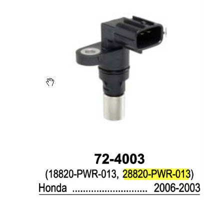

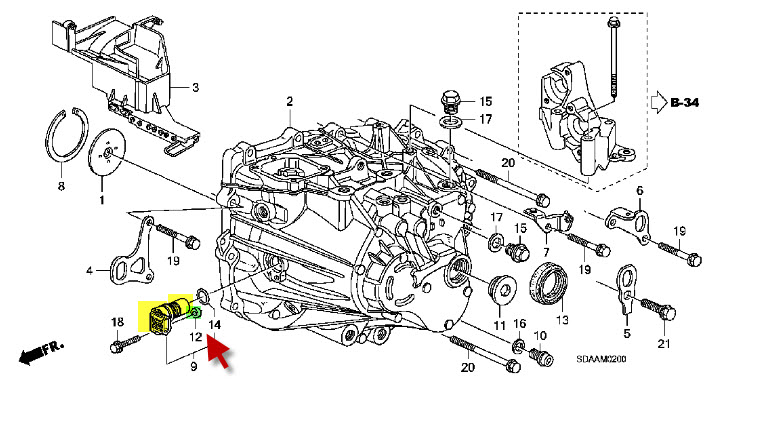

After you remove the speed sensor (aka pick-up assembly), examine to see if it is intact. (The attached picture from CarQuest shows how it should look like intact.) Make sure when you install a new one, to also install the washer, #12 in parts diagram, it is works as a spacer too.

Thanks for the input. The person who installed the clutch told me to bring it by and he would put a Shim under the new pick up assembly. I thought that comment was a little odd, now i know he forgot to put the washer back on the original one. Thanks again

No problem. Yep, that's what I was suspecting had happened which contributed to the problem.
