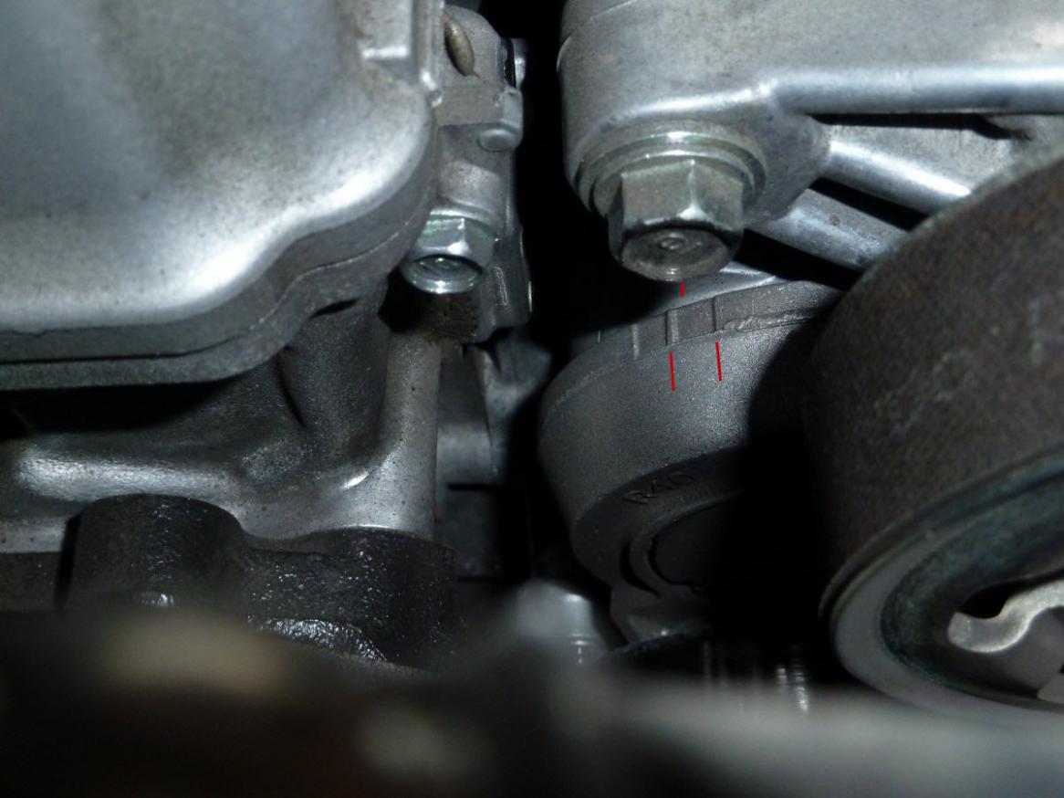

Check that the drive belt tension is okay. On the tensioner, there is a pointer and gauge. The pointer should be between the range marks in the picture I've attached. The pointer is not actually shown in my picture. If the pointer is in range, start the engine and observe the position of the pointer while the car is idling. If the pointer moves or fluctuate a lot, then the tensioner needs replacement
