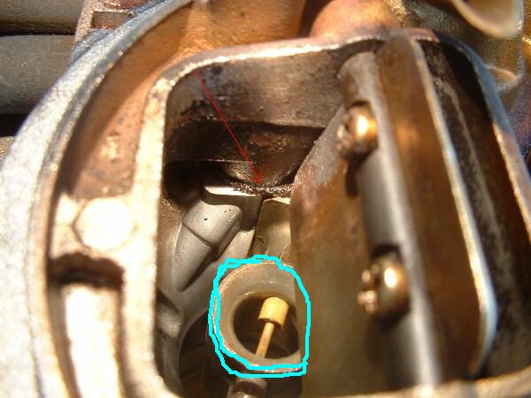

Yea not the funest thing in the world but you can replace the float needle/seat without removing the float - been there, done that.
I did this one weeknight after work in my "poorer days" - meaning it was my only way to work and knew I couldn't drive it with gas washing down the cyl's and into the crank case....at the same time I had to be at work and had no other car to drive.
First thing we need to do is confirm that it is the float needle/seat. You made a comment that you pulled the top and the bowl was empty?
Random pic attached. Pull the top of the air cleaner and the screen over the top of the carb - start the car (cold will help) and look down the throat and notice if you see gas dripping in the carb once it starts to warm up - take a pic of the throat of the car and note where you see gas "drops".

Ok, made my readings thru the threads and what the heck. IF IT IS the float needle and seat: Here we go, this is from a ~six year old memory and done on an 87 LX 5 speed. We will assume the float is good - no breaks in the plastic. Wish I had pic's and IF you decide that this is your issue please take and post some.
To remove the float needle and seat the float has to come all the way down. Two ways, remove the pin - which I was not able to do without worry of breaking more.
So once you have the top of the carb off - hold it in the air and you will see that the float only goes "down so far". There is a small plastic tab on the float that rests against "something" (I said this is from memory).
I used a dremel tool to grind the plastic tab on the float - SLOWLY. Once the tab of the float is close to the stop/resting place. Stop. Gently bend the plastic tab away from the stop - remember this is plastic that has spent ~25 years in gas.
The reason this is important, you have to be able to push the float tab back above that stop to hold the new needle in the seat. If you grind that tab too far the float will "fall" all the way down, allowing the needle to fall out when you try to re-install it.
Not sure this is making sense. Again if you are unsure, take pic's of the float and the top and I'm sure that will "jog" my memory.
