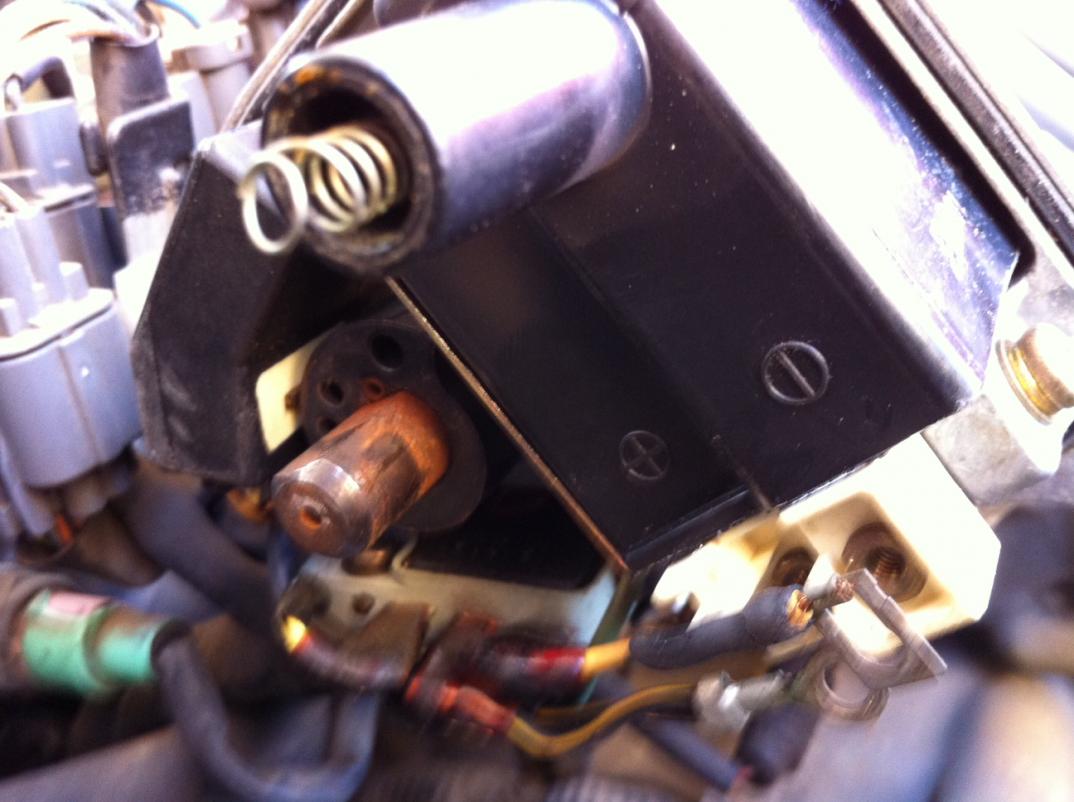

I have a 1990 Accord LX that in the span of 7 days has shut off twice while the engine was running. All the lights on the dash turned off the first time it shut off. (I do not remember if the same happened the second time it shut off). I have heard that the igniter in the distributor, ignition coil, ignition switch and a relay that powers the ignition and fuel system could be the causes of the problem. The car has plenty of gas in the fuel tank and the engine does turn over but it really seems like it's not getting fuel. Any recommendations?

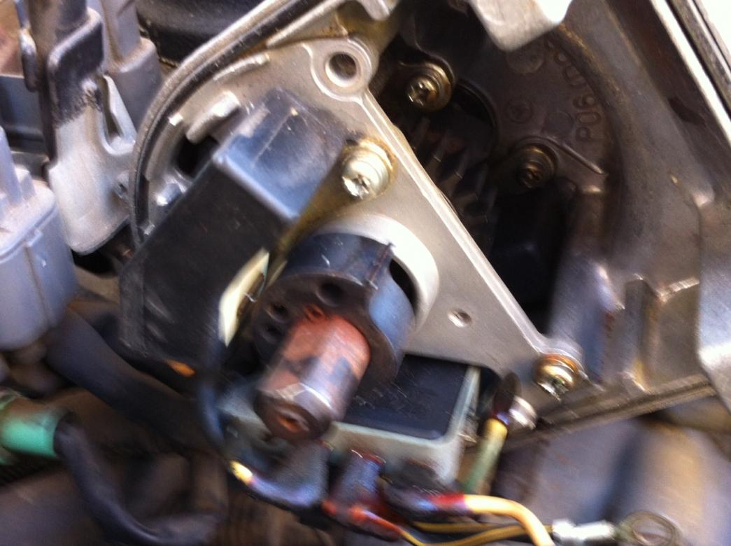

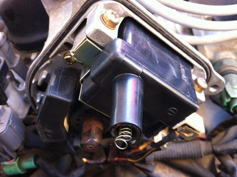

Where exactly is the igniter and ignition coil in the photos that I have posted?

The coil is the big thing with the bent-distorted spring coming out from the post.
The ignitor is visible in picture 2 & 3 towards the bottom with the wires attached.

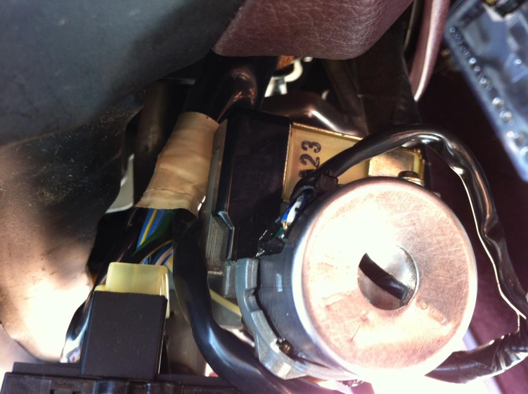

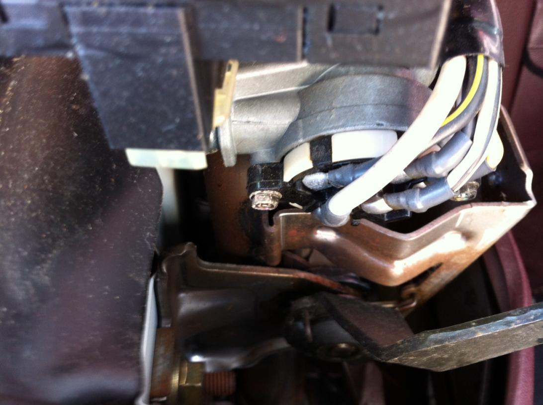

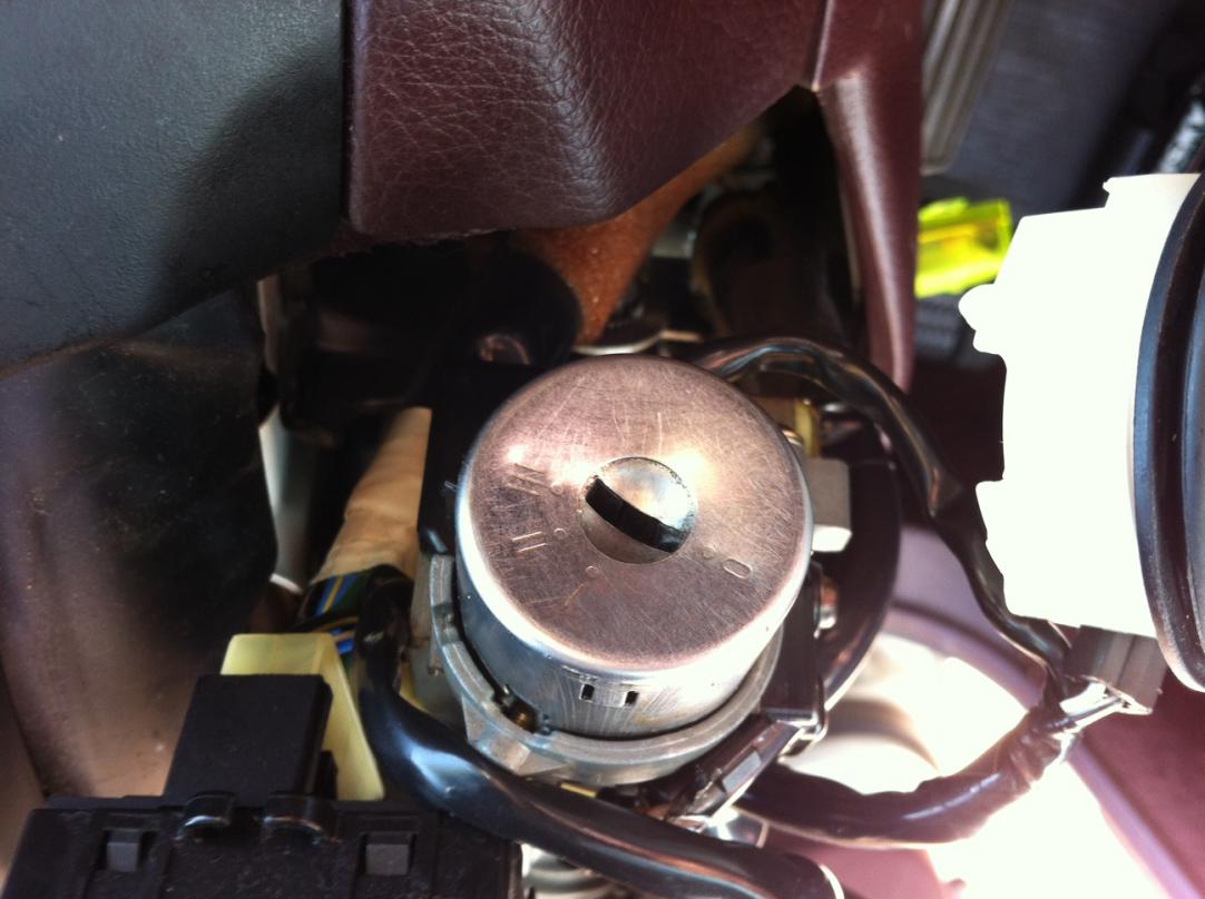

I attempted to replace the ignition switch but had little luck.....all I managed to do was take off the steering column cover and unscrew some wires (no worries....I know where everything goes back). I called a friend of mine that has a '92 Accord and said that the ignition switch is behind the key cylinder. One problem though....I put everything back together and now the key won't cycle all the way to the run position....it will only cycle to one or two positions (can't remember). Here are photos I took. The key cylinder is 20.00 new and switch is 50.00 new. I plan to replace both. Is it ok to just take out the old key cylinder and install the new one OR do I have to figure out why the key won't cycle all the way to run position first before I put in a new key cylinder?

Might pull the elect part and replace just that and see if the key "frees up". In the third pic you can see the two bolts/screws holding the elect part of the switch.
For the "key part" there are security bolts that will have to be removed.
