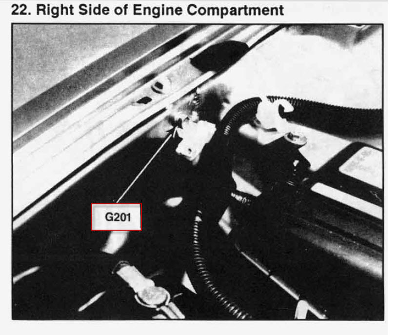

There are several tests for code 20; but, first check that under-dash fuse no. 2 (15A) is okay.
Old Aug 14, 2014 | 10:14 PM
  #27
Posts: 7,101
Also, check the wires and ground connection at G201, located on the right side of the engine compartment. See attached pic.
