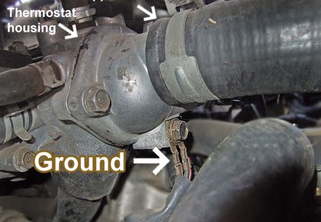

Around the t-stat housing, there is a ground wire...make sure it is clean and tight.

You need to perform some checks. If no spark, are you getting 12V to the Blk/Yel wire at the distributor and is the important ground secure that Poorman mentions?
No voltage at distributor would suggest intermittent keyswitch assy.
Do the checks and post your results.
Old Oct 18, 2011 | 06:35 PM
If that ground is missing or has gotten loose....you loose the ground to the ECU which can will cause a no spark situation....since you just replaced the head....IMO, a good place to start.
