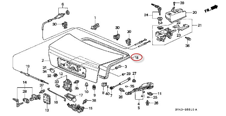

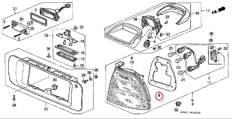

For water in the trunk, check the trunk lid weatherstrip and the tail light gaskets first.

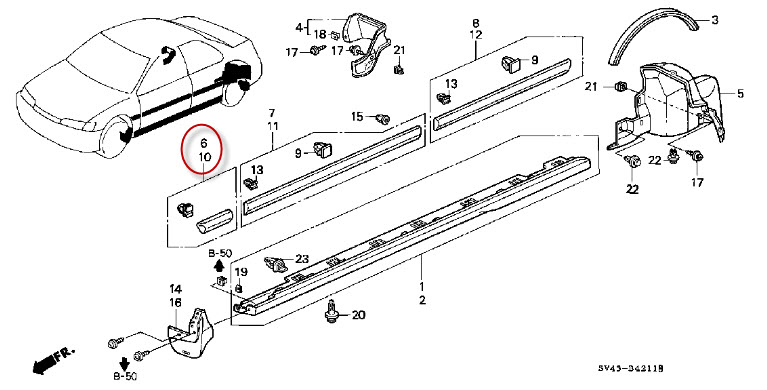

The trim piece is the fender protector. They usually come unpainted. You can order it from an internet Honda dealer, go the dealer, try a salvage yard for a painted one.
hondaautomotiveparts.com/auto/jsp/mws/prddisplay.jsp?inputstate=5&catcgry1=ACCORD&catcgr y2=1995&catcgry3=4DR+LX&catcgry4=KL4AT&catcgry5=PR OTECTOR
