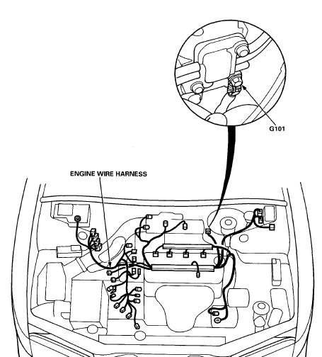

Two common issues I can think of:
Check the main ground for the ecu is clean and tight. G101
After that, be sure the TPS and MAP sensor plugs are on the correct sensor.
Attached Thumbnails 1994 honda accord ex wont start-5th-gen-g101-location.jpg

well i checked the grounds and they seem fine..and i plugged everything back where it went because i labeled that much...i thought maybe i had timing a little off but just went and reset it to be safe and still nothing...as soon as i can get someone to come over i will double check for spark...but after a few seconds of trying to crank it and then i stop...it sound like it might be back firing what could that be from?
