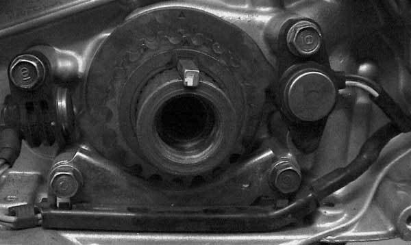

Originally Posted by pmb1903
And ae they built into the sprocket? Can they go bad but how are they read by the cyp sensor if that's down by the crank and the cyp sensor itselft is built into the distributor housing? Idk I guess I'm jut curious asking all I can lol knowledge is power lol
I'm not talking about the CYP (cylinder position sensor) in the distributor, I'm talking about the CKPS (crankshaft position sensor) that's behind the crank pulley. I'm pretty sure it's mounted to the oil pump housing.

The main relay might have been a distraction. If the fuel pump always primes properly, and your problem has already been narrowed down to spark (only #3 gets spark) then I don't think the main relay is involved here.
The "pulser" & "reluctor" are just the type of sensor that is the CKP, CYP, & TDC sensors. It's just a kind of miniature "metal-detector" with some metal tabs or teeth that pass close by to generate a signal.

Measure the TDC & CKP sensor resistance at the plug by the timing cover and again at the ECU connectors. This thread might be helpful:
1997 Accord shutting off no start with cel
...and this thread, post #11 showing the FSM diagnostics page:
honda-tech(dot)com/showthread.php?t=3016441
