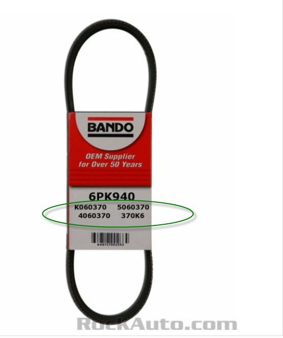

Go to the rockauto site and it will show alternator belts without A/C, made by various makers. Some even have belt length info.
Old Oct 6, 2019 | 07:17 PM
Chaoz's Avatar
Joined: Oct 2019
Posts: 4
From: NJ
Didn't even think of that. There is a few. I'll order one from there and see how it goes.
Old Oct 6, 2019 | 07:34 PM
You can even check locally for a belt; for example, the Rockauto info. link to the Bando belt show some cross interchangeable belt numbers (which can be googled) under the Bando number. The belt length is shown in the link too.
https://www.rockauto.com/en/moreinfo...R6hAYvqWZmA%3D
Old Oct 6, 2019 | 07:55 PM
Chaoz's Avatar
Joined: Oct 2019
Posts: 4
From: NJ
They all point to being 37 in or 37 1/8th. Bought one off ebay for $11. Didn't need it immediately, the car can sit for a few days.
