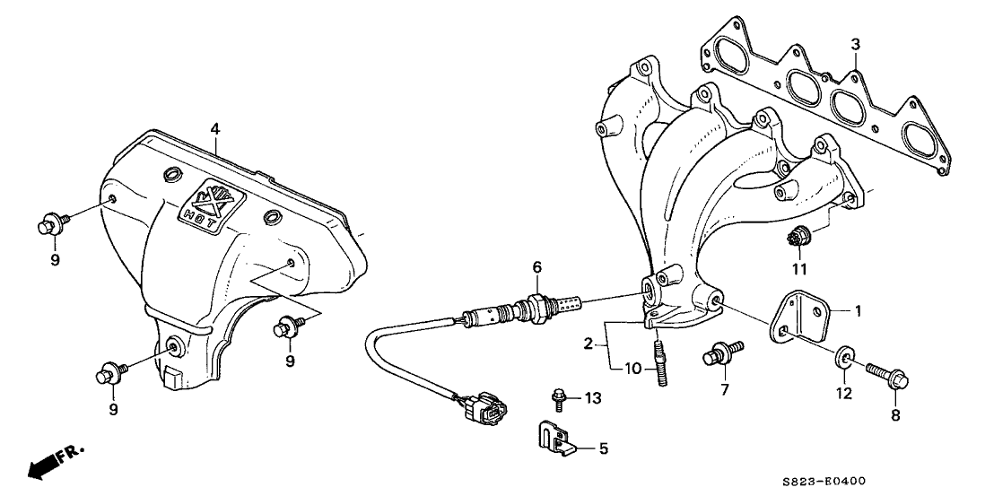

I have a 2002 F23A1 2.3L V-TEC 4cyl. engine. My o2 sensor looks to be in the pipe from the manifold, if i'm not overlooking it?
Old Feb 7, 2018 | 11:30 AM
  #26
In the manifold according to this...
Attached Thumbnails 1998 4cyl 4 door - Proper front/flex pipe-2002-exh-man.png
Yours is probably just a regular "49 state" LEV car/engine. It should have a single outlet manifold, and use a flat gasket with 3 bolt holes in it. Look on e-bay for one, as that's what I did. In fact the last time I looked, the guy I got mine from was still selling them for 75 bucks.

mine is in the manifold. I would like to replace it one day. Thanks, I'll look into it.
