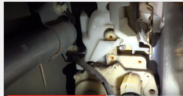

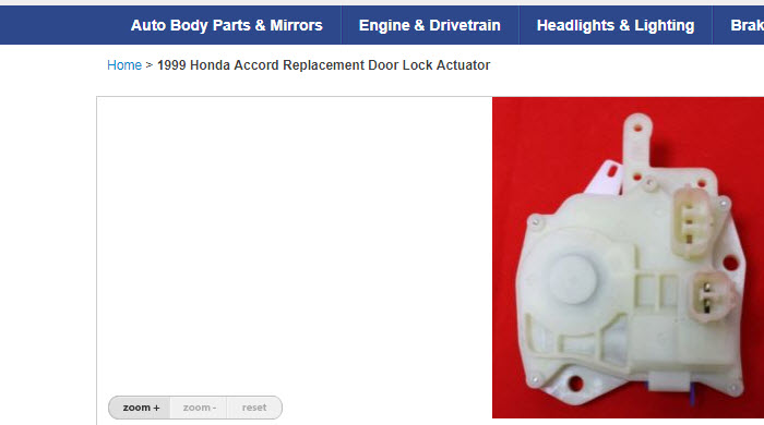

I am having a difficult time with the installation of 1999 Honda Accord V6, EX passenger front door actuator.
I have installed this with the three small screws and two larger screws on the backplate.
I have also verified the electrical connection works.
When I use the keyfob. The automatic door locks perfectly. However, when I try to unlock with the keyfob, the passenger door does not work.
Any ideas or suggestions. It will lock with the keyfob only. Unlock with keyfob does not work.
Thanks for any ideas and suggestions.
Attached Thumbnails 1999 Honda Accord V6, EX passenger front door actuator-actuator.jpg   1999 Honda Accord V6, EX passenger front door actuator-actuator1.jpg
Old Aug 6, 2017 | 11:30 AM
A little background - why did you replace it in the first place?
Press the unlock button twice on the remote??
First press it unlocks the drivers door only.
Second press (within a couple seconds) it unlocks the rest.
