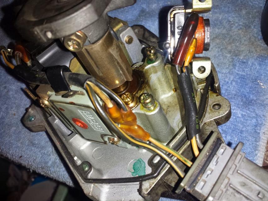

There is a "flat" looking four wire connector coming out of the dist. The BLK?YEL wire is one of those.
This is a pic of a dist from an F23 engine that should help in finding the connector/wire.
Right now I don't think it is the dist - I'm still leaning towards the elect part of the key switch.....of couse testing is the only way to know. The 6th gens did seem to have more issues with the ign switch than the other gen's - in fact I'm pretty sure there was a recall from Honda. Even if it was replaced under the recall it does not rule it out.
