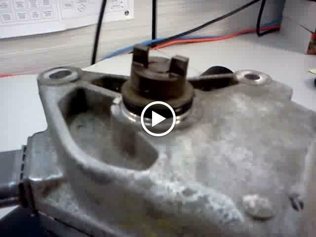

will do and report. I am picking up a O-ring tomorrow at the dealership? Should I also get a distributor cap seal?
Although, one tricky question is, how do I keep the rotor from not moving when switching from existing to new?
In this video, I show a notch on the housing, a wedge on the ear-like thingy that sticks or is attached to the cam shaft. Finally, when I turn it, as it makes a full circle, I can feel the shaft almost "locking" into a position. Not sure what all the three mean?

The carbon button (I called it a brush) is actually visible in your photo. It presses against the center of the rotor. It has it's own spring. I once got a distributor cap from the store where that one is missing.
The spring visible at the top of your photos makes connection to the coil, which doesn't spin so it doesn't need a carbon button.
The shaft of the distributor has a blade that fits into a slot on the end of the camshaft. You will notice that the blade & the slot are a bit off-center. Pay attention to that off-center direction and spin the distributor around to match it properly. If you get it 180-degrees out, it IS possible to install but you'll have to hammer it into place. You would think the need for hammering would be a clue, but it has been done.

I will confess to having mis-installed a distributor and I didn't "hammer" into place. It merely needs installation 180 deg off and tightening the bolts. It will be cocked at a slight angle, but will mate and turn over w/ starter. Mercifully it won't start in this configuration.
The problem is the key is almost symmetrical. It is nearly impossible to detect the slight asymmetry by visual cues.
The best clue to improper installation is the slightly cocked position and gap on one side of the distributor. If anything "doesn't feel right", stop and take a close look.
