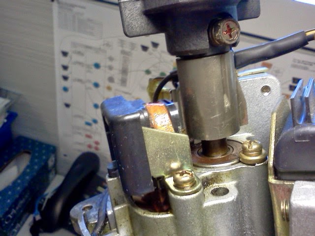

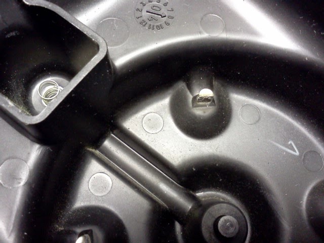

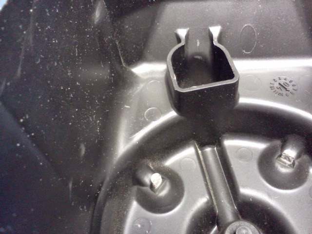

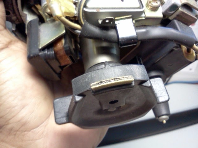

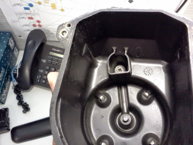

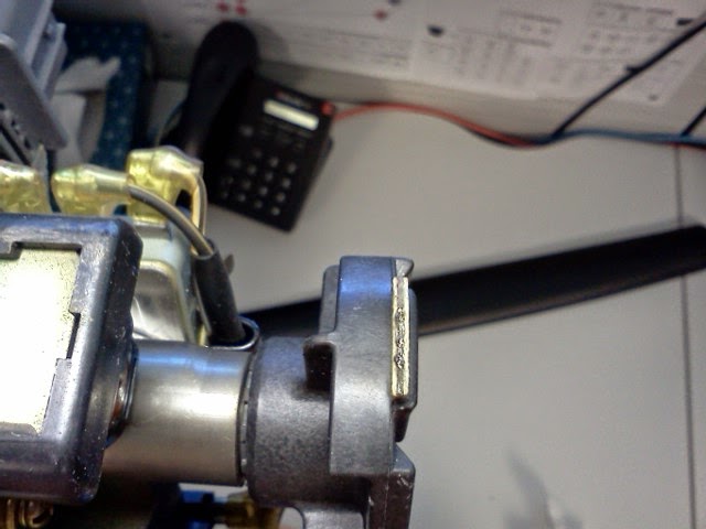

Default pictures of the distributor I picked up at the junkyard
Link to all pics - jolpot: distributor pics
Hmm, I thought there was no internal leak when I opened the cap at the junkyard yesterday. But, I did a stupid thing to let gravity do its work based on how I placed the dizzy on the floor mat. Oil on the engine side(cam shaft?) must have seeped, is this normal? You can see shiny/wetness on the cam shaft connecting the rotor.
Do I need a new Cap?
Do I need a new Rotor as well? The tip of the rotor is rough and serrated.
Finally, i dont seem to see a carbon brush around the spring in the distributor cap? Is this normal?
Attached Thumbnails 2000 Honda Accord SE - hot summer afternoon-img701.jpg   2000 Honda Accord SE - hot summer afternoon-img697.jpg   2000 Honda Accord SE - hot summer afternoon-img707.jpg   2000 Honda Accord SE - hot summer afternoon-img703.jpg   2000 Honda Accord SE - hot summer afternoon-img699.jpg
Old Sep 7, 2014 | 12:21 PM
  #40
1. Oil doesn't look that bad......don't worry with it for now.
2 & 3. Compare your current cap and rotor to the ones in the pic and go with the best looking ones.
4. The "carbon" brush is the thing in the center of the cap. There is not one on the "coil" side that I can find.
Slap that bad boy in and see what you have.....hope the issues go away.
