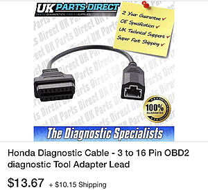

Are you talking about using something like this. If you are using a regular obd2 then it shouldn't work. You need something that can read obd1.
