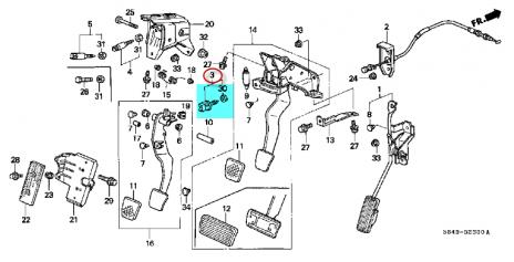

Might want to check brake light and cruise switch?
Honda part number: 36750-S84-003
Attached Thumbnails 2001 Accord V6 Cruise Control Problem-brake-cruise-switch-assembly.jpg
verified the cruise switch last night with meter. switch opens and closes properly on 2 pins. will need to perform same test with brake light switch when i get home, but i'm fairly certain its working since the brake lights work properly.

Problem fixed!
Turned out to be very simple. It was the brake switch, which seems to be the culprit for many Honda owners with cruise control issues. Had to take a wrench and bent the metal flap towards the switch so it would engage properly. I guess over time the metal flap needs adjusting.
Good luck to everybody else with the same cruise control problem.
