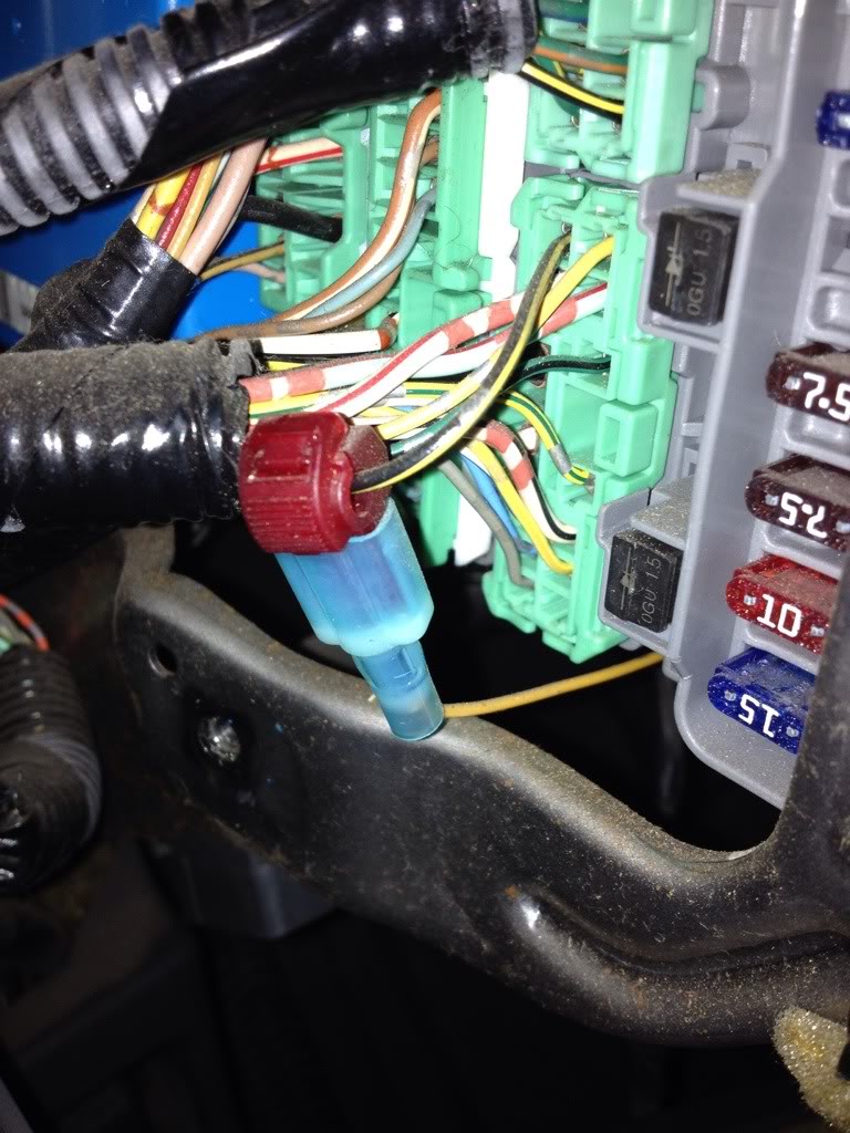

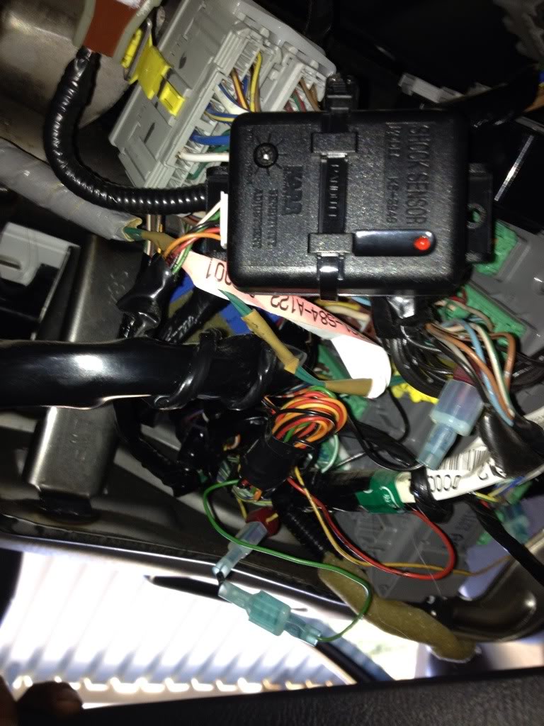

What are your thoughts on this. This is the driver side fuse box...

Well someone has done something to this car.....that "tap" into the BLK/YEL wire is a concern.
Then just me but that butt end of the the tap that has the yellow wire coming out of it in the first pic......I hate to see a "power" wire resting right to a "ground" source.
Then in the second pic there seems to be a green wire with issues.
What is all of this aftermarket stuff for?

Those were my thoughts exactly lol. I followed those wires and it's a shock sensor. I'm guessing a factory alarm add on? Idk...

And with that green wire there is a diode. If you look closely in the 2nd pic it's in between the two spade terminals.

The aftermarket alarm may be a distraction....You have 12v on the BLK/YEL, this is good. Are you getting spark at the plug?
Pull one of the plug wires and insert a spark tester/or spark plug. Ground the plug and crank crank the engine over - do you get a blue spark from the plug?
