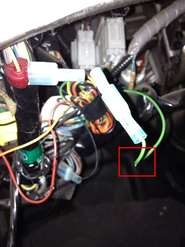

My concerns in these pic's
Attached Thumbnails 2001 EX p0300, p0302, p0304, p1399-delete.jpg   2001 EX p0300, p0302, p0304, p1399-delete1.jpg

Now what I see what you mean about the green wire lol Idk why it came out looking like that in the pic but i checked it again and the insulation on the wire is fine so it must have been some dust or something on it. I got it running again. This time with CEL code p1381 so it came out to be the new distributor housing was faulty so I took it back under warranty and got it running again.
