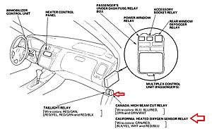

There is a relay to power your a/f sensor. I attached a picture of the location. If the taillight relay next to the a/f sensor is identical, swap the relays. See if your a/f sensor gets power to the red wire and check if your tailights stop working. That is a quick way to rule out a relay.

I was typing a detailed message and lost it when the stupid browser refreshed! I had the same problem with my 2001 Honda Accord 4-CYL LX ULEV F23A4 engine with P1164 then P1167 after replacing the A/F sensor. Anyways long story short, below are the steps I took.
1) BUY the right sensor! For this case, sensor 1 for ULEV Honda Accord for F23A4 engine is the one with the green cover cable!!!! BUY a thread chaser and A/F sensor removal tool. Here is a kit with the thread chaser included. --> [url=https://www.amazon.com/ITEQ-Automotive-Oxygen-Sensor-Removal/dp/B07P24HCY1. I bought a thread chaser separately. Here is the link. --> [ame]https://www.amazon.com/gp/product/B000XETMW0]https://www.amazon.com/ITEQ-Automotive-Oxygen-Sensor-Removal/dp/B07P24HCY1. I bought a thread chaser separately. Here is the link. --> https://www.amazon.com/gp/product/B000XETMW0[/ame]
2) I had checked for air leak, bad MAF sensor, bad A/F sensor heat element relay, which I still don't where the hell that relay is located even someone posted a photo previously. I am lucky that my relay is good. OK, YOU NOW MUST CLEAN YOUR THROTTLE BODY. Here is the thread I posted how I cleaned my throttle body--> https://www.hondaaccordforum.com/for...16/#post401103.
3) Now use the thread chaser to clean the thread of the A/F sensor's hole.See this video here. -->
5) Then install your new A/F sensor. AND reset the P1164/P1167 codes using ODBC II reader.
6) Do a drive cycle as prescribed in the Honda Accord's user manual.
Hopefully, the code won't appear! So far, it's not with my car, after I had done the above steps.
Btw, I could never locate the heated oxygen sensor relay as shown from the poster at https://www.hondaaccordforum.com/for...62/#post380464. I guess I am lucky that my car's heated oxygen relay still works. If anyone has pictures of the exact location, please post!!!
