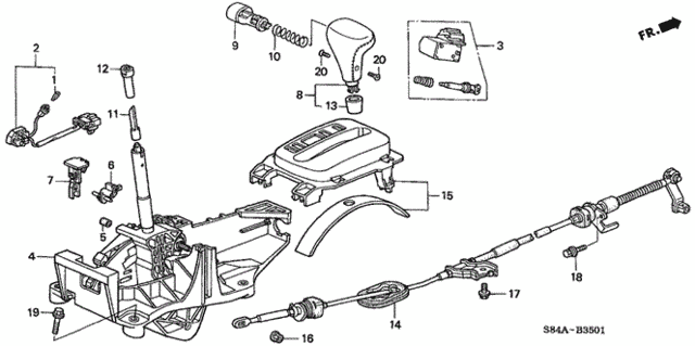

There's a cable from the shift selector lever going forwards to the transmission. Not sure where it's adjusted.
But if the transmission actually shifts properly, the lever selects P-R-N-D etc. correctly, then maybe the cable is OK.
Look at the "park switch" #2. Is it loose? Maybe it's position can be adjusted? I don't have an automatic, so I'm guessing... But that is the switch that says you're in PARK and energizes the solenoid to release the key.
Attached Thumbnails 2002 Accord V6 can't remove key sometimes unless go out and back into park-2002-v6-selector.gif

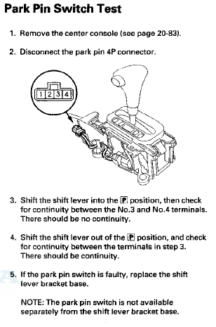

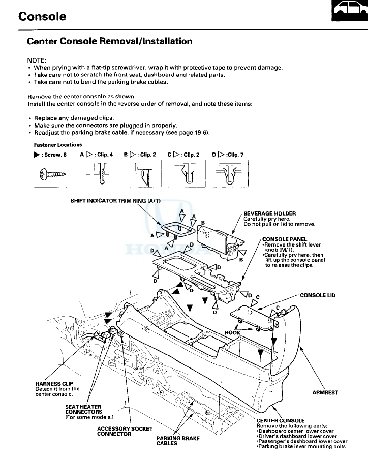

Thanks JimBlake. The transmission shifts properly. Never has a problem. I need to check whether the Park light is on when the key won't come out. I assume I have to take the console apart to check the park switch? I can't tell from the diagram where exactly it is. Best

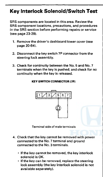

Default 2002 Accord V6 can't remove key sometimes unless go out and back into park
Here's 3 things out of the shop manual. Beware, I only have the manual for the 4-cyl Accord, but I suspect this area is the same.
Attached Thumbnails 2002 Accord V6 can't remove key sometimes unless go out and back into park-1998-2002-console.png   2002 Accord V6 can't remove key sometimes unless go out and back into park-1998-2002-key-interlock-test.png   2002 Accord V6 can't remove key sometimes unless go out and back into park-1998-2002-park-pin-switch-test.png
Old May 23, 2018 | 03:22 PM
I'm not sure about the interlock for starting the car. The park-pin-switch test seems to imply that it only detects the lever in PARK, not neutral. I'm not sure how they do the starter interlock - maybe that's done inside the PCM?

That might be the other part of the "park pin".
