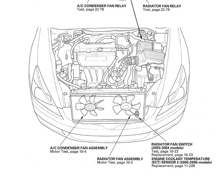

Fuse 9 and 11 are not blown. They are both 20 amp fuses. I looked for a switch by the bottom of the radiator and found 3 connections. One went to the AC compressor. One was on the driver side heading aft. And the last I have no idea. The AC compressor wire looks okay but you can see the blue of the outer sheath. I checked for nicks or shorts and no cigar.
Exactly where is the switch and how should I check it? I have a multimeter if that helps.
Old Sep 1, 2012 | 10:46 AM
  #19
For the fan switch - see if this helps
Attached Thumbnails 2003 Accord 4 Cyl Overheating-7th-gen-4-cyl-rad-fan-controls.jpg

Found the switch and it looks okay. I filled the car today with peak coolant(going to flush and get type 2 soon) and took it for a drive with no overheat. Got back and the reservoir was empty. So I'm thinking either:
There is a lot of air in the system from when I took the coolant lines off the throttle body while replacing the starter.
or
There is a leak in the coolant system.
or
Coolant is leaking into the engine block.
What do you think?
How can I verify any claims?
