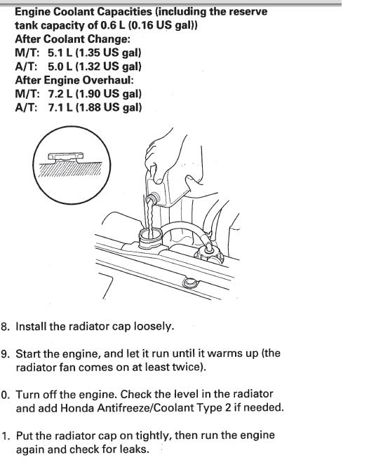

WARNING - Do not burn yourself with HOT COOLANT
Top of the rad and res. Install the rad cap loosely - first click. Start the car - turn heat to MAX. Let the car run until the fans cycle. Turn the car off, top off rad.
The reason you intall the cap "loosely" - first click - is so that no pressure will build up in the system. Air and some coolant will escape from under the cap when running.
Attached Thumbnails 2003 Accord 4 Cyl Overheating-7th-gen-4-cyl-coolant-refill.jpg
Thanks! How long should it take before the fans run? I live in Texas and it is over 100 degrees everyday.
Old Sep 3, 2012 | 09:21 AM
  #27
Given your location and temp - ~20 min - keep an eye on the gauge during this time.
