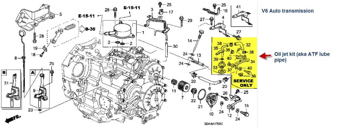

The oil jet kit (aka ATF lube pipe), Honda P/N 06250-RDG-315, was designed for the 7th generation Accord V6 transmission, not the 4 cylinder. It was part of a recall on certain 2003 & 2004 Accord V6. It was available as a service item for later 7th generation Accord V6. It is installed where the oil filler bolt is on the V6 auto transmission. The 4 cylinder auto transmission didn't have such an oil filler bolt; so, it the kit was not applicable to 4 cylinders.
Background:
Certain operating conditions can result in heat buildup
between the countershaft and secondary shaft 2nd
gears in the A/T. Without enough oil flow to dissipate
heat, prolonged operation under these conditions can
eventually result in decreased material strength. In
higher mileage vehicles, this can result in gear tooth
chipping or, in very rare cases, gear breakage.
In most cases, A/T noise will indicate a problem,
however it is possible for the A/T to become locked
without warning. A locked A/T could result in a crash.
Honda TSB 04-037
This is for informational purposes only.
