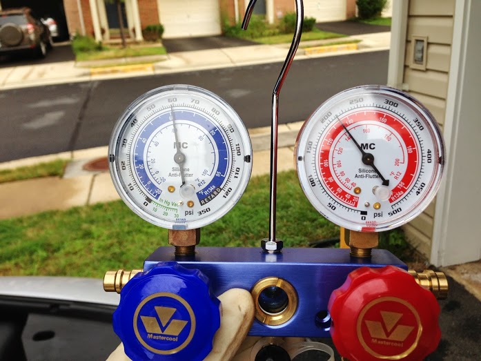

The manifold gauges I have are working properly.
A working AC system from a 2008 Acura TL
This one below is from the 2004 Accord after I force the compressor to engage by jumping the ac pressure switch.
When I disengage the compressor while the engine is still running, low side pressure rises to 50 psi. High side pressure never moves and pegs at 100 psi.
I honestly don't know what is going on. I feel that the compressor is doing its job but at the same time don't want to tell my friend to spend the money to find out. I know the low side pressure may look low but the freaking thing just don't want to take a charge whether I force the compressor to turn on or not.
