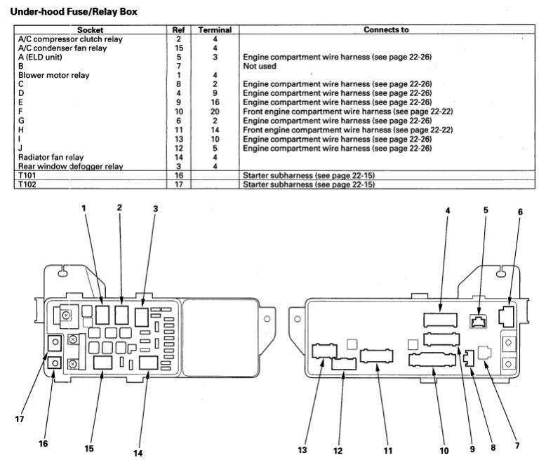

One other item that could cause your problem is the blower motor relay. Using a volt meter would be one way to figure out if there was no power getting to the blower. Another way to test a relay is to swap it with another identical relay. Your blower motor relay is #1 in the attached pic. Swap it with the a/c compressor clutch relay, #2 in the pic. The attached picture is of the fuse box in the engine bay. If the blower works and the a/c doesn't blow cold, then you determined the relay is the problem. This is simple to do, so maybe do this first.

Thanks so much for your advice! We already did the relay test and the relay is fine. The only thing we didn't do was hook the blower motor directly to the battery to see if it worked..we were limited on time. We just gave the Accord to our daughter and she had to go home 5 hours drive away. Nothing like driving through pouring rain and storms with NO DEFROST! They had to keep rolling the windows down to see. We want to have her boyfriend try to install a new blower motor (knows NOTHING about cars)..so I thought I would ask for any other problems it could be first. There are no videos to have him watch to install a blower motor..but there are only 3 screws and 2 plugs..we are hoping he can manage that! Do you think there could be anything wrong with the controls? All the lights come on..Oh and I don't think it has climate control. Its just basic AC/Heat, fan dial with vent choices and defrost.
