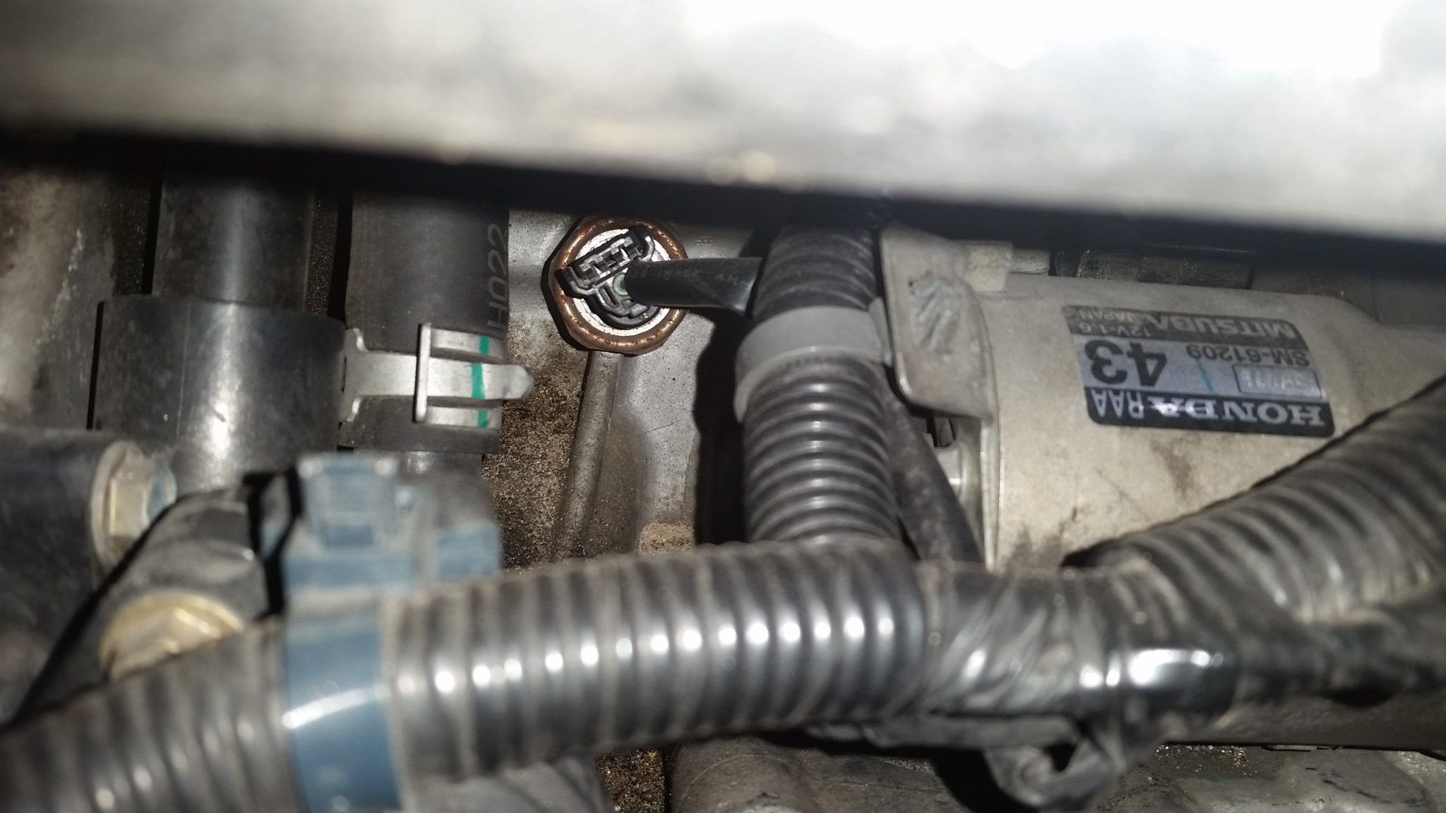

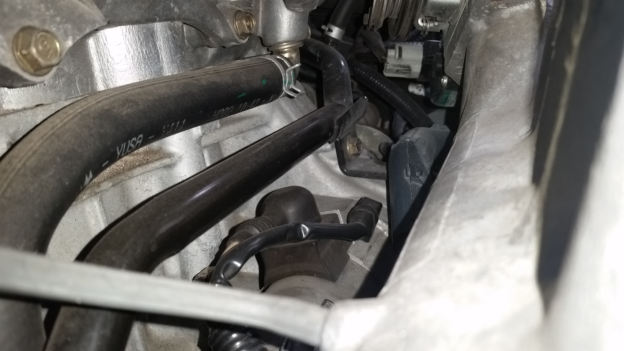

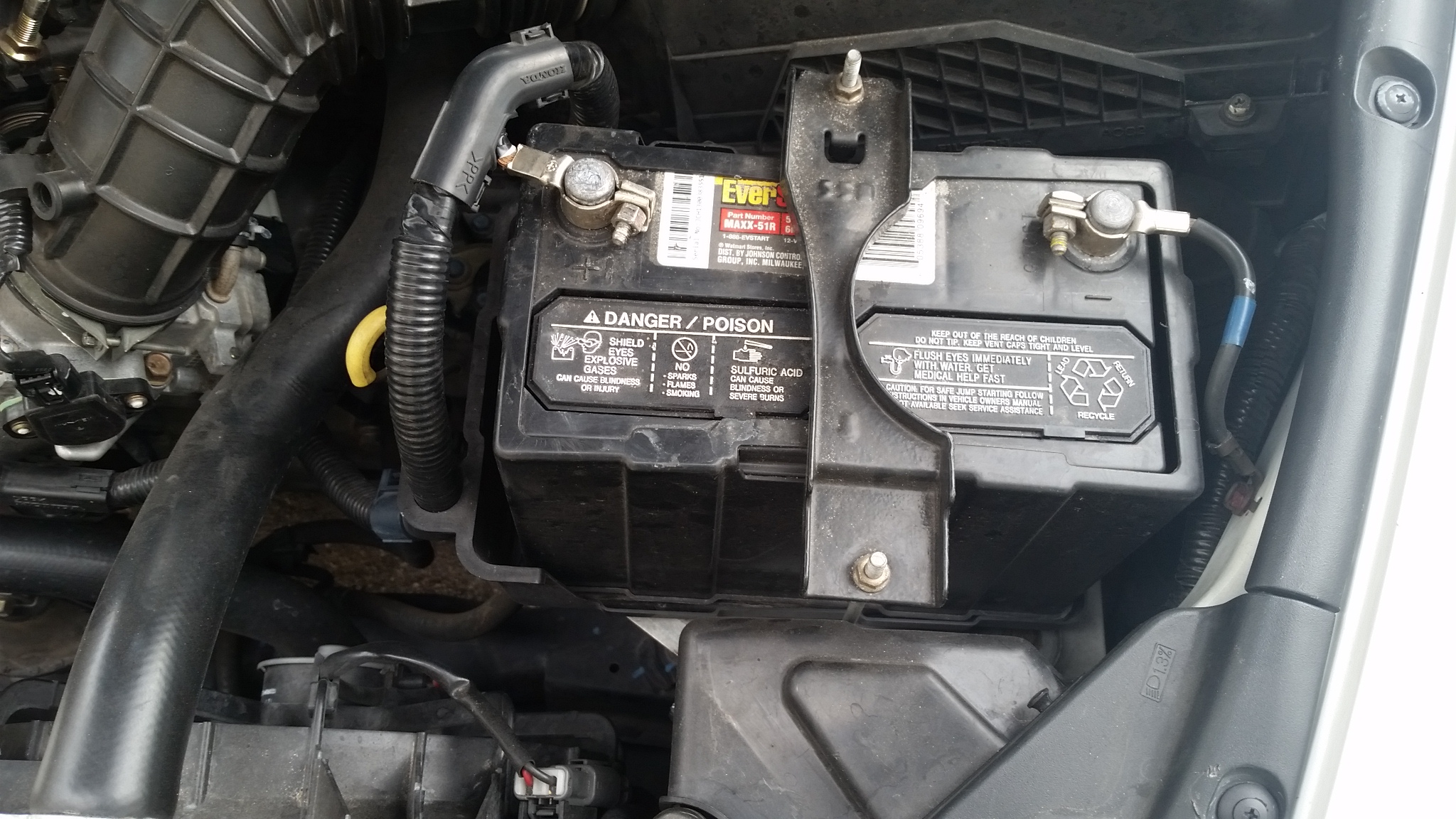

Here are some photos. I will have to wait to test the black wire when the car doesn't start, it could be weeks. I don't see any loose connections or corrosion.
