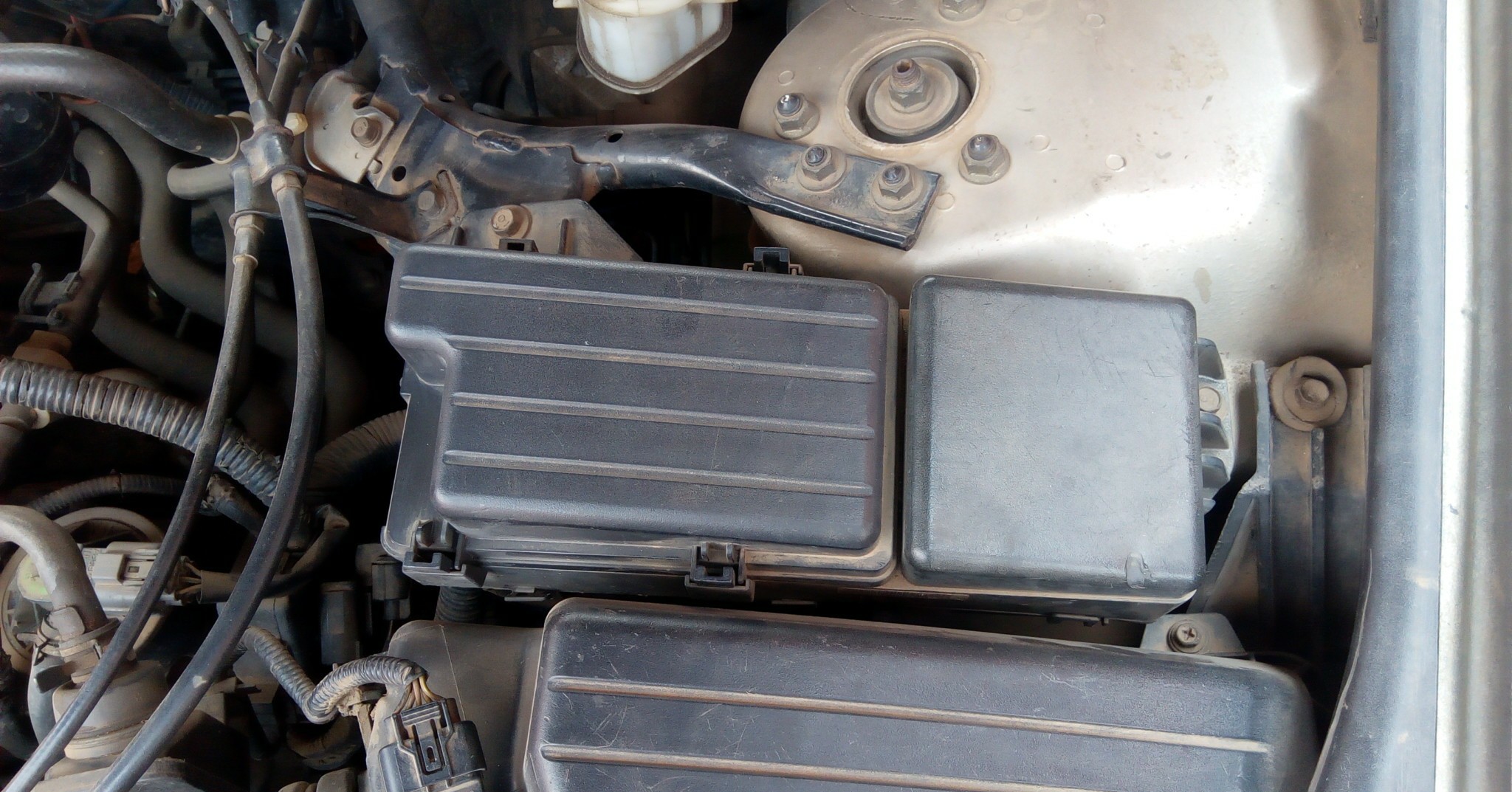

I did a physical trace of the headlights' wires. They all went straight to the relay control module (see pic) which cannot be opened. And, as I stated before, no special DRL unit or DRL relay.
Also did some thorough inspection and concluded that there was absolutely no rewiring by the previous owner. All wires are still stock.
I'll just leave it alone for now.
