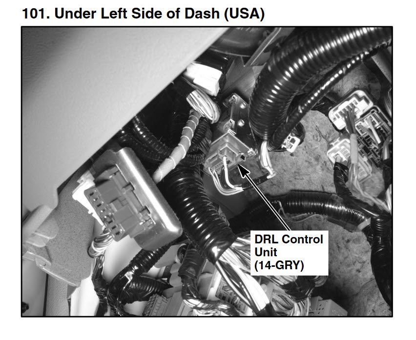

2006 U.S.A. model Accords also had the DRL control unit under the dash, which you previously indicated you could not find.
This is a photo image of the control unit and location.
