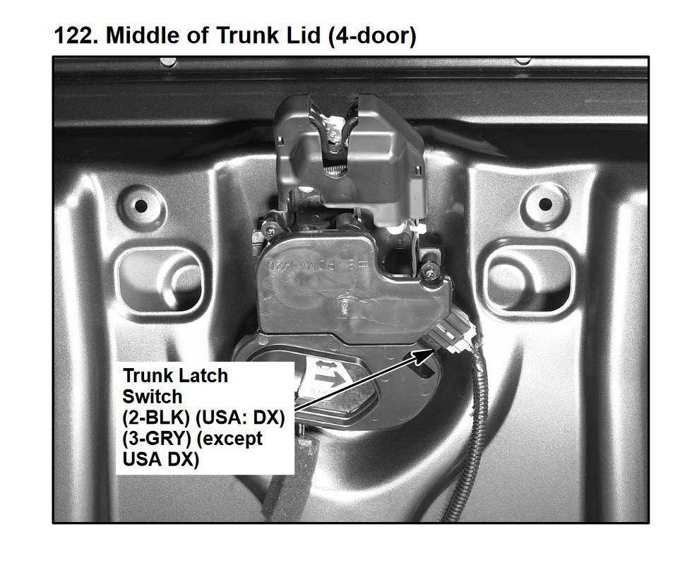

Here are some photos of some of the switch connectors. The door lock **** switches are part of each respective door lock actuator assembly. You don't have to close the door/trunk/hood when you disconnect the respective switch to test; unless, something else stays on in that door or trunk.
The security system monitors the following signals:
  • Battery voltage
  • Door lock **** switches
  • Door switches
  • Ignition key switch
  • Radio connection
  • Security hood switch
  • Trunk key cylinder switch (sedan)
  • Trunk latch switch
