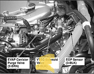

Ok, mind if you share a pic or something of where it is located on my car.
Some videos show it down at the oil filter, but when I search the part number you told me it shows it up at the top of the motor on the drivers side. I looked last night and there is some solenoids up on drivers side top of motor. I haven’t look down by the oil filter yet.

You have a oil pressure sensor and an oil pressure switch. The sensor sits inside the VTEC spool in the middle driver side.
Your switch sits on the oil pump by the filter.
The one causing your issue is the sensor sitting on the spool.
Old Oct 16, 2019 | 12:08 PM
Seanjordan20's Avatar
Joined: Jun 2017
Posts: 1,225
The highlighted point to the spool which has the sensor attached to it.
