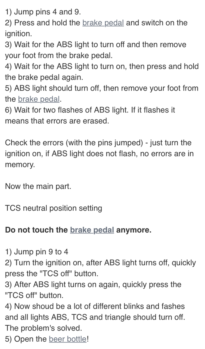

How do you do a reset on the system?
Old Jan 6, 2020 | 03:56 PM
  #42
Seanjordan20's Avatar
Joined: Jun 2017
Posts: 1,225
I think this was meant for you. I forgot to add it to my previous post
