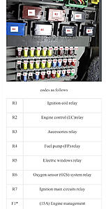

I took the glove box out and there are 4 relays on the left side of glove box area. One of those four are clicking when the TCS light and exclamation light comes on. My dad has some spare relays and we are going to change those out. Do you know what those relays are for?
Yes sir, there are 4 relays on the left side behind the glove box. From what I have found from google, the 2 on the right are the throttle actuator control module relay and the one behind it is the seat heater relay. Both of them are the same size relays. The throttle actuator relay is the one clicking, I took it out and started the car, it did the same thing except this time there was no clicking noise when the TCS and exclimation lights kicked on. I took the seater heater relay and put it where the Throttle actuator relay was and it still through those 2 lights after 30 seconds of idling. So I know now its not the relays.
I also unhooked the battery and cleaned both cable ends and the terminals really well, and checked the grounds. All the ones I could see looked good. I am thinking about limping over to the parts store and having them scan it, after I reset the ECU and the lights kick on.
