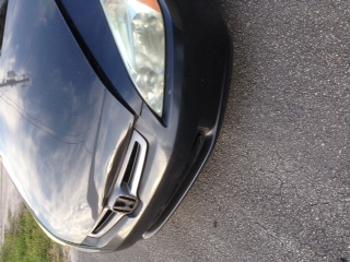

Ok cool, just to add I was in a small fender bender where I was hit from behind the hit into another car. Minor front end damage to the front left of my car, bent my hood and push some plastics around. Wondering if this is contributing to anything to a short or something.2005 Honda Accord LX, No Interior Lights-img_0369.jpg
