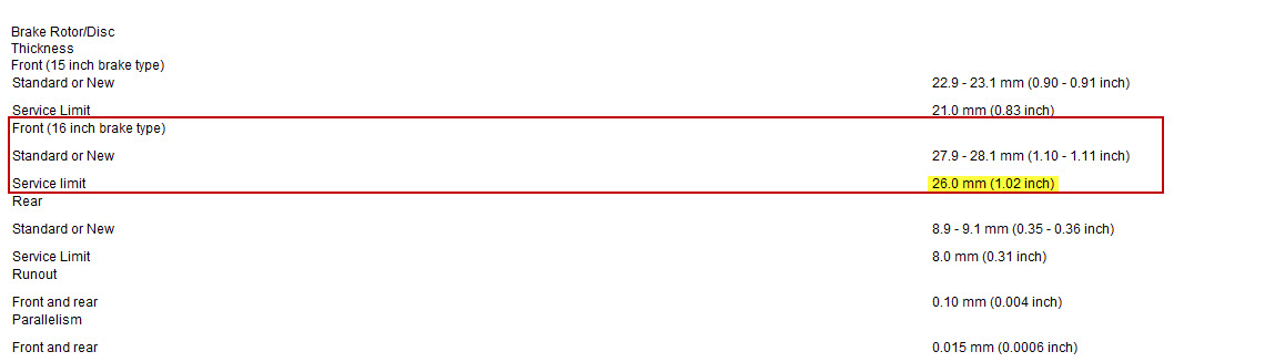

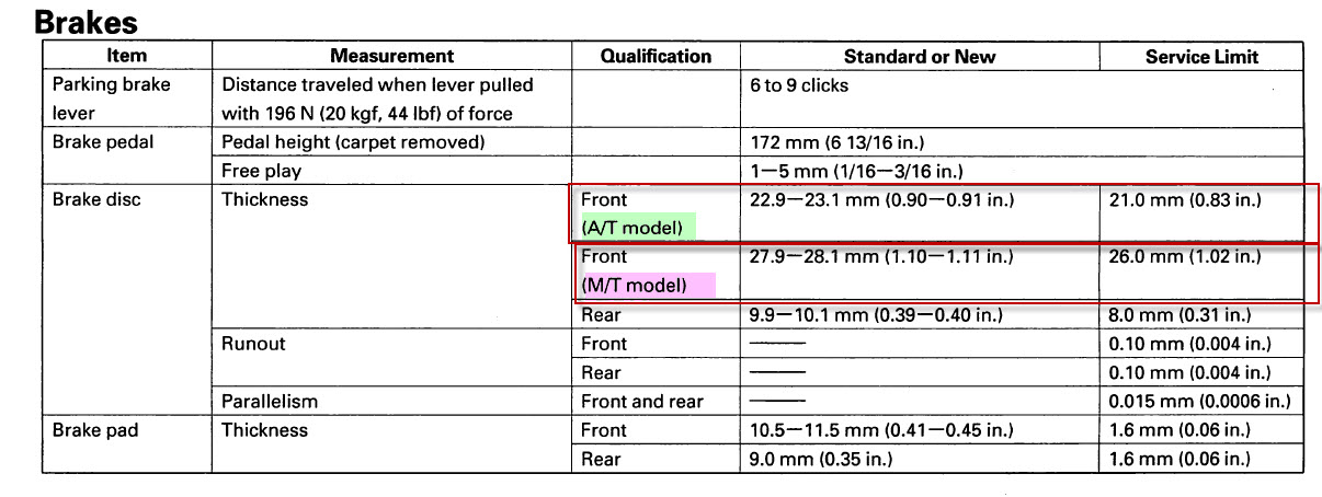

Is the car manual transmission or automatic transmission?
Old Feb 27, 2016 | 12:13 PM
  • For V6 with manual transmission, Honda calls them 16 inch brake type and yes, the rotors size is smaller than that. The front brake rotor is 11.8 inches.
  • For V6 with automatic transmission with 15 inch brake type, the front brake rotor is 11 inches.

Thanks Redbull , I though that was the reason for 2 different size rotors, one for the Auto and one for the stick shift, I have the Auto Trans. Of coarse the guy at the auto store did not know why there was 2 sizes
