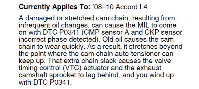

Depending on engine operating conditions, the estimated oil life varies. The oil life is calculated, it does not actually analyze the oil or know the fluid level. -- If they used synthetic motor oil, then there is less to worry about. For the 2011-2012 Accords, Honda recommend 0W-20. Honda 0W-20 is a synthetic blend, which is probably okay. If the dealership put in some non-synthetic 5W-20 oil, then I would be somewhat concerned.
For 4 cylinders, which have the timing/cam chain; infrequent oil changes can cause the chain to wear and stretch, which may cause the timing to skip a tooth or more, with possible engine damage.
See link: https://www.hondaaccordforum.com/for...-cam-chain-jpg
Note: Although the pic. link I attached states 08-10, the 11-12 are same K24 engine block.
