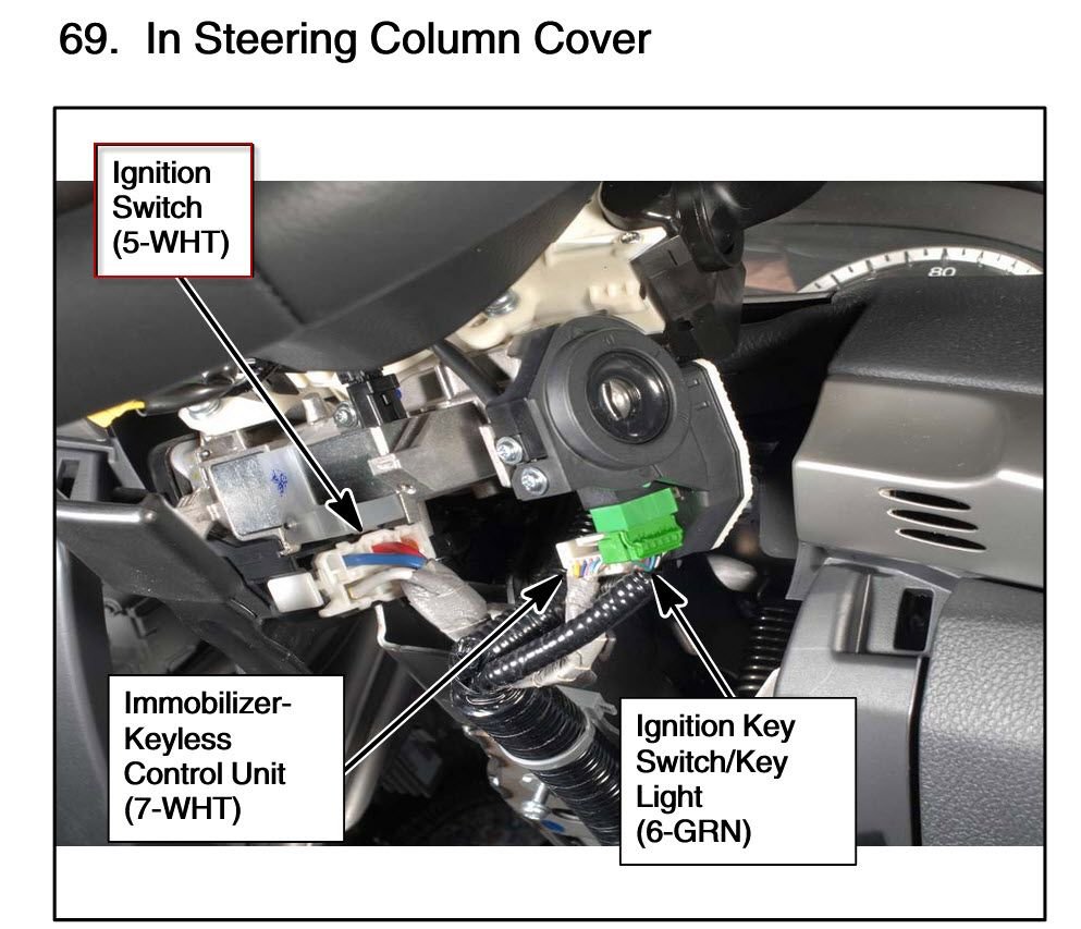

The 50A fusible link that is part of the Under-hood Fuse No. 3 multi-fuse principally protects and provides power to the ignition switch circuit like you mentioned. Are there any aftermarket electronic accessories on the car?
You may want to remove the steering column cover to see if there are any shorts and/or spliced made into the ignition switch wiring.

The ignition switch wires also run to Connector F at the driver's side under-dash fuse box; so, take a look at the wiring there first.
