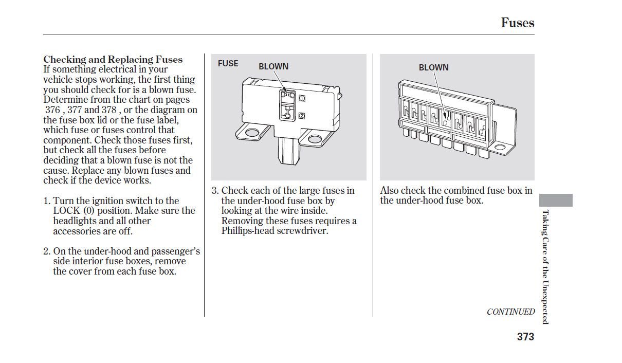

You'll have to look for what's burned. Especially look at the large fuses, like the ones that are fastened into the fuse box with screws.

It would be the under-hood Fuse No. 1 (large multi-fuse) and driver's side under-dash Fuse No. 7 (5A). The No. 1 fuse for a V6 is different than for a L4 engine.
