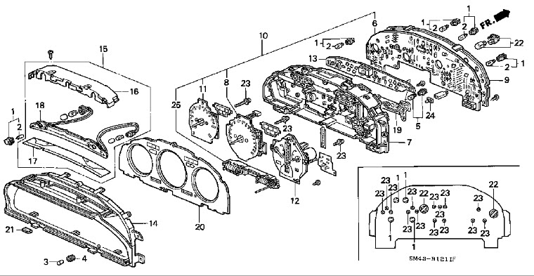

Old Oct 8, 2011 | 09:03 AM
Posts: 7,101
The 4th gen Accords are different than 5th gen Accords for the circuit board for the speedo. IIRC, 4th gen Accords are more like a single mother board. 5th gen Accords are more like a mother board for the instrument panel and a separate daughter board for the speedo.
Edit: Although the 4th gen instrument panel is different than the 5th gen, from looking at the parts diagram you might still be able to replace just the speedo portion and get it to work.
