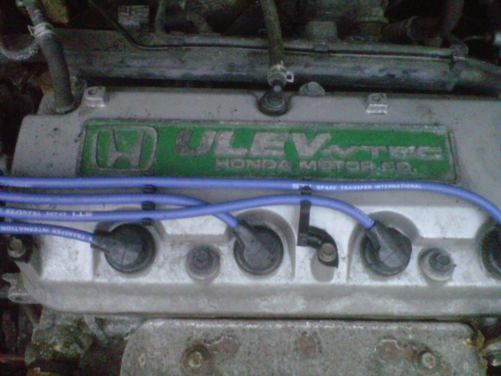

For 1998-2002 there's 3 different 4-cyl engines. For easiest swap, the car should match the engine.
- non-VTEC (Accord DX)
- VTEC (LX & EX)
- ULEV-VTEC (California car that might have moved out to the east coast?)
If you can do some wiring, just make sure if it's ULEV or not.
DX (non-VTEC) can swap with LX or EX (VTEC non-ULEV) without too much trouble but you have to add a few wires for VTEC. Or leave them hanging if your daughter's engine is a non-VTEC. Grab the ECU from your daughter's car before the crusher gets it.
Swapping a ULEV engine into a non-ULEV car or vice-versa would be a big hassle. Wiring harness is a lot different.

Thanks for the replys! Its a ULEV. Now I know what to look for.

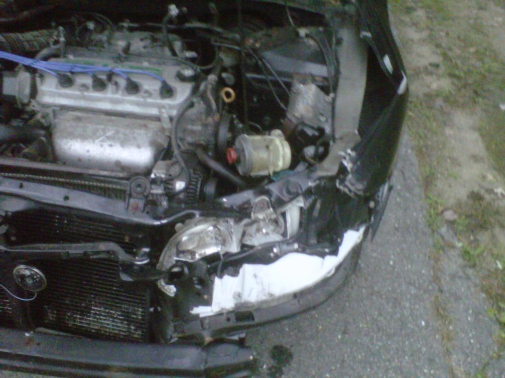

Next question: After the accident, there is no battery power at all to the car. Before pulling it, I'd like to start the engine. The battery and cables are intact and I pulled the radiator support out with my truck. The air bags never went off. Is there a cut-off switch or something that would have tripped in the accident preventing battery power to the car?

Old Oct 8, 2011 | 07:59 AM
No power to anything, I'd check the main fuses in the underhood fuse panel (do the haz lights work).

Interesting.....the hazards do work....will check fuse tomorrow!
Old Oct 9, 2011 | 07:12 AM
Not going to dig out the wire diagrams yet, but most of the time the haz lights use a totally different circuit than most of the other things on the car.
...check the fuses, the "main" ones I was talking about are the higher amp (40 and up) ones with the window on top.

Maybe Piggylover will share some more details, but here's what I think...
If you can't find a ULEV car, try to find a VTEC car (LX or EX). Use the exhaust manifold and front O2 sensor from the non-ULEV car. Along with the PCM from the non-ULEV car. That basically turns your engine into a non-ULEV VTEC. (You could be clever & swap the valve covers so it doesn't say ULEV.)
