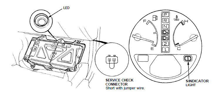

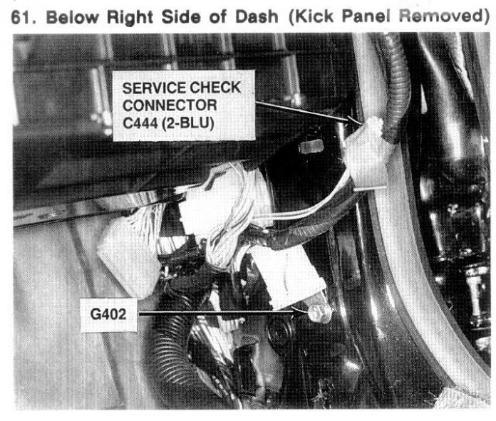

The flashing S Indicator light means that the A/T control unit senses an abnormality.
Use a jumper wire to short the Service Check Connector (located to the lower right of the glove compartment) and the S indicator light will blink the problem code when the ignition switch is turned on.
Problem codes 1 through 9 are indicated by individual short blinks, Problem codes 10 through 15 are indicated by a series of long and short blinks. One long blink equals 10 short blinks. Add the long and short blinks together to determine the problem code.
(Also, see the Common DIY and Info. threads sticky at the top of this forum too.)
Some early Accords also have an LED display on the A/T control unit that will blink a problem code when the ignition key is turned on.
It can turn out to be the TCU again, as it is a common problem on 4th gen Accords with burnt resistor(s) and/or blown capacitors.
Attached Thumbnails 91' Accord "S" Light Issue-4th-gen-accord-service-check-connector.jpg   91' Accord "S" Light Issue-tcu-s-light.jpg
